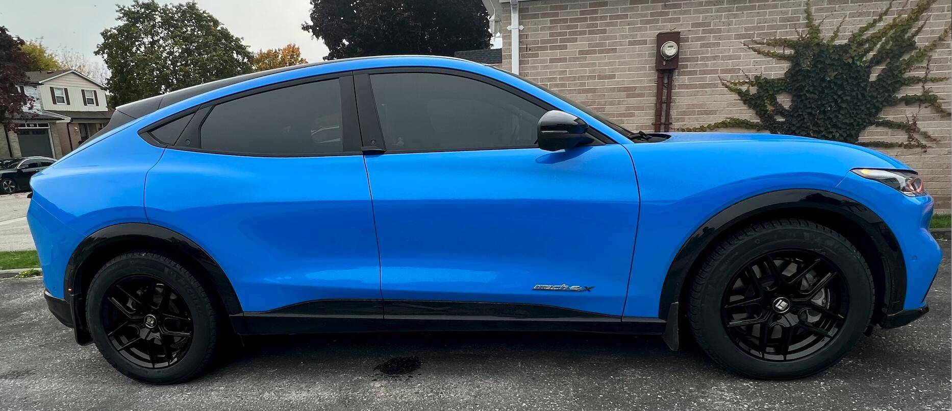

The non-GTs and GT can fit most but not all 18" rims. The clearance can be very tight, so most do work, but if you are buying a model you don't see someone using here on the forums, make sure you have a good return policy just in case the fitment doesn't quite clear.
The GT-PE will definitely not fit 18"s, will fit some 19"s, and basically all 20"+.
I think the MachE looks best with either 18"s and chunkier tires (235/60R18 is good), or 20" and lower profile tires. 19" is just in the middle and doesn't make much of an aesthetic statement either way, and there aren't as many available options for winter tires.
Even at 18" the clearance is pretty tight. My wheels had just enough room to clear the brakes + wheel weights.
235/60/18 fitment looks pretty good though.
