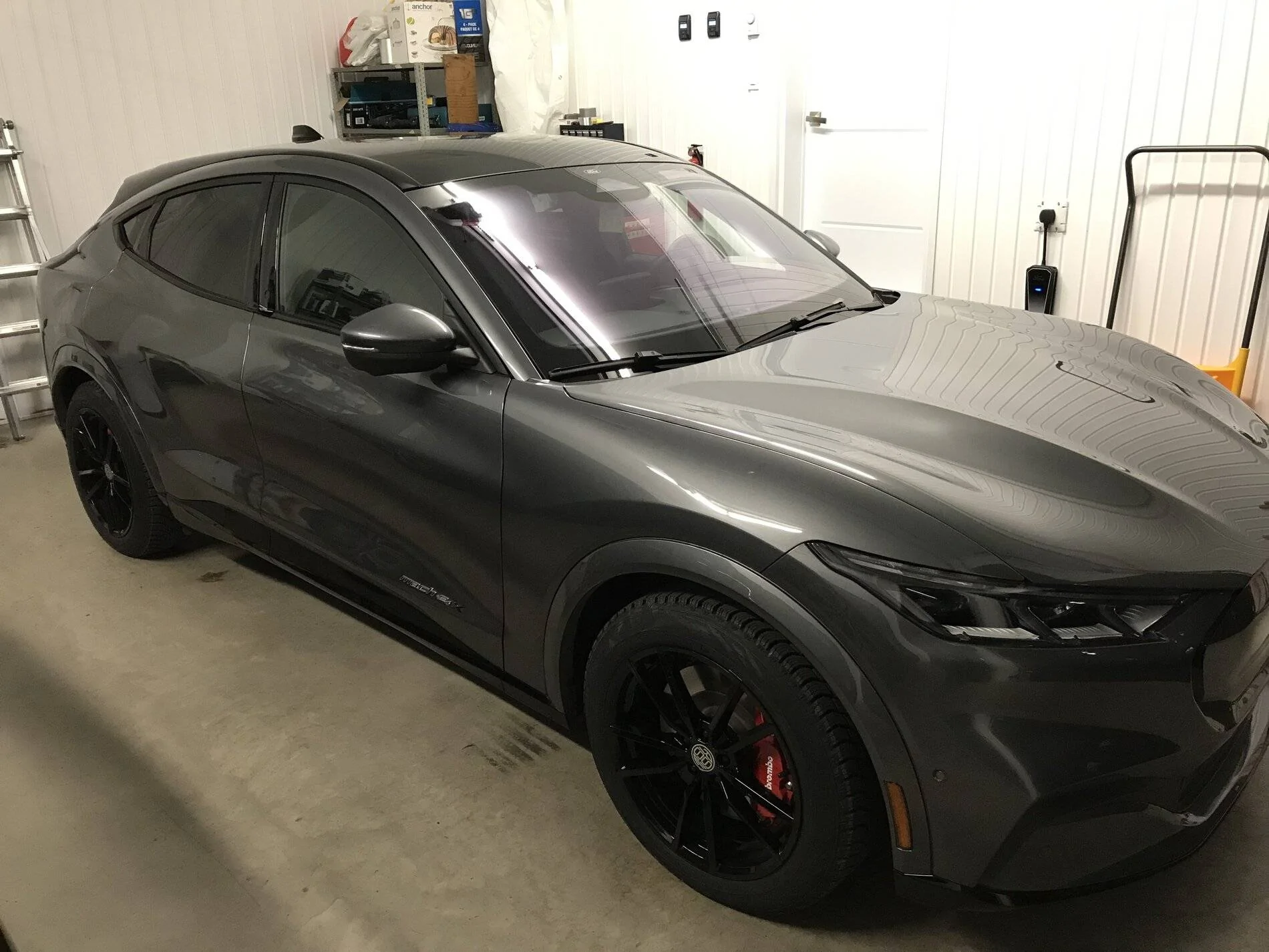

FE, went with Nokian hakkapeliitta 225/55 r19 103r xl on Grid azz958ggb wheels, very silent.

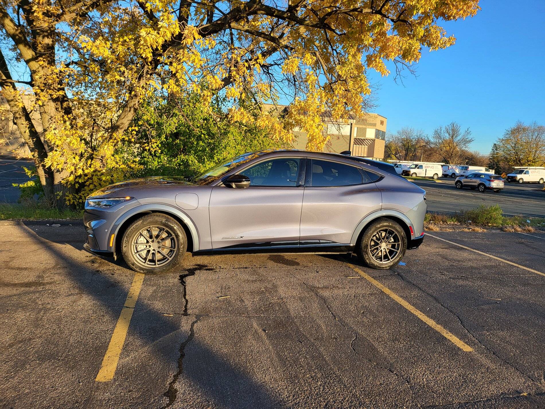

Here ya go 225/60/18 TSW 18x8 wheels. These are all weather Vredestein Quatrac 5.
