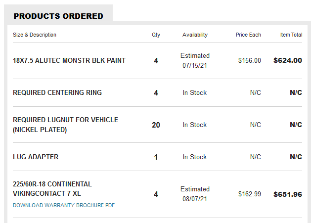

surprised no one's mentioned downsizing your winter rims.my select RWD is on 19s, but i prefer downsizing and going to a taller, narrower tire for winter. lighter, cheaper, and cuts better. i bought this setup from tire rack.
Ford Mustang Mach-E Winter tires 1630532856366
it'll be my first time on any continental winter. i've had, on other FWD cars:
  • Michelin xIce 2 and 3 (on a toyota sienna minivan, truly unstoppable snow tire)
  • General Altimax Arctic (on a mazda 3, not thrilled with these and would not buy again)
  • Blizzak WS80 (also on a sienna, very good tire)
i've always just bought the cheapest alloy wheel (in the smallest size i can get) and swapped the wheels in the driveway when the seasons change. i used to do it when i changed the oil - i guess i'll need a different schedule with the mach-e!
i think someone recommended getting the aero wheels for their winter wheels. i haven't tried them in the winter, but in general i recommend NOT buying winter wheels that can trap snow and ice. it's super annoying and probably dangerous to end up with a big block of ice stuck between spokes of the wheel, or the wheel cover and the wheel. throws the wheel balance off completely. would not recommend the aero wheels for winter for that reason.
