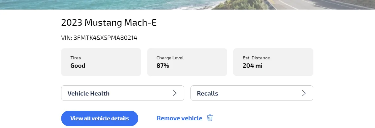

as Rick suggests, check the state of charge of your 12v battery. To do this you can go to ford.com log into your account upper right corner click on person icon, then click on "........account" NOT "vehicle dashboard", the screen will bring up 12 v battery state of charge. Ideally you should see it range from 80-95%. less than that could indicate a failing battery.
Also, it's a good idea to not use "accessory mode" in the car more than you have to as this discharges the 12v battery.
