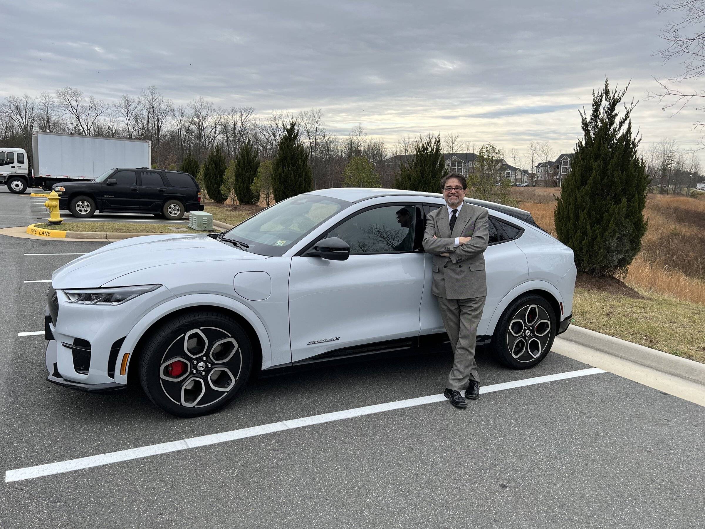

ā€œIt’s a plane! It’s a rocket! No, it’s a Mach-e GT!!ā€
Lotsa fun to drive, makes me feel 20 all over again. Though ā€œyou be careful out thereā€¦ā€
