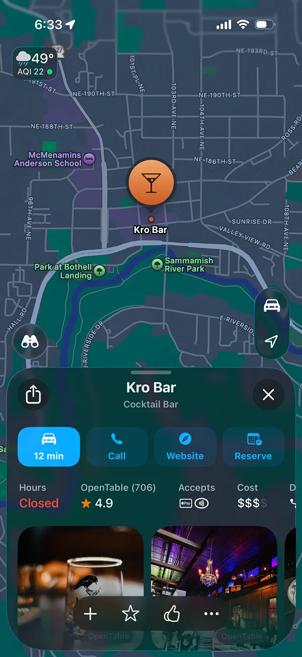

^^^ Basic Physics - the torque wrench handle acts as a lever, providing a Mechanical Advantage. Just like a crowbar. Which is also the name of a pretty cool bar in London if you like Heavy Metal...
Ours is misspelled
