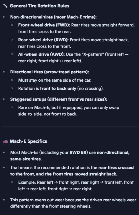

Here is the pattern Ford recommended as well as many other manufacturers
Ford Mustang Mach-E Manually tighten up wheel lug nuts? 1763174069004-3d
Following this pattern each tire rotates through each corner. Take front left tire as an example.
at the first rotation, it goes to right rear, at the second rotation it goes up to the right front, at the third it moves back to the back, the rear left. At the forth it takes its original spot, the left front.
This is supposed to be the best way to ware every tire in a same degree.

I remember a long time ago it was bias tires cross and radial front to back. It seems it has gotten more complicated over the years. And as such I will bet most people haven't keep up with it. Of course, the overall goal is just to have the tires to wear as evenly as possible. As long as that is happening then most likely for the most part it probably doesn't matter.

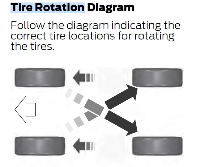

This must be AI generated nonsense, because it's wrong, i.e. not what the manual says.
Ford specifies in the manual that the rear tires come forward, and the front tires rotate diagonally to the rear.
Rear left => Front left
Rear right => Front right
Front left => Rear right
Front right => Rear left
Does it matter that it's different? No, what matters is that it's consistent. Discount Tire actually specifies the same as AI. But we should be posting what the manual says, and then explaining you could do it differently as long as it's consistent each time.
That said, I vote the @Administrator ban AI posts. We never used to have any.
