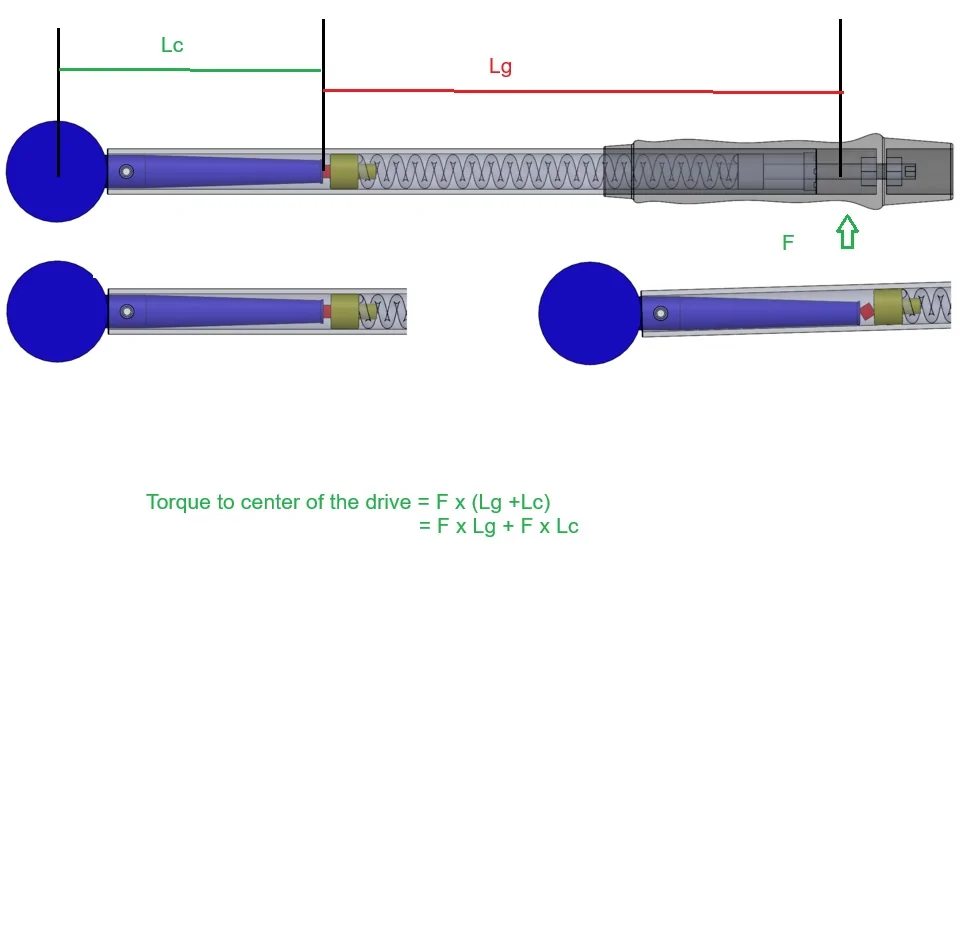

Now you are talking about physics. Let's take a look at the physics inside a click type torque wrench
Ford Mustang Mach-E Manually tighten up wheel lug nuts? Torque VS distanc
Fx lg, the torque to the red block is what makes the wrench click, it's calibrated. Yes, it doesn't matter where you pull the wrench at, as long as F gets it click. BUT. the smaller the Lg meaning the closer to the drive, the bigger the F, the bigger the F the bigger the force applied to the red block, then the bigger the torque to the drive. It's now over torqued.

the issue with applying force other than at the handle of the torque wrench was/is a thing for beam-type wrenches with an indicator pointer that extends from the socket end back to the handle. These wrenches work by measuring the amount of bend in the arm from the handle back to the socket. Applying force anywhere other than at the center of the handle interferes with this measurement. Digital or click-type wrenches measure the force at the socket, so force can be applied anywhere along the lever arm.
F (regardless of it's magnitude) is not applied to the red block at all. It is squeezed on one side by the spring which pushes it against the ratchet (blue). It is not contacted at all by the hollow handle, which transmits all of the force/torque directly to the ratchet (blue).
