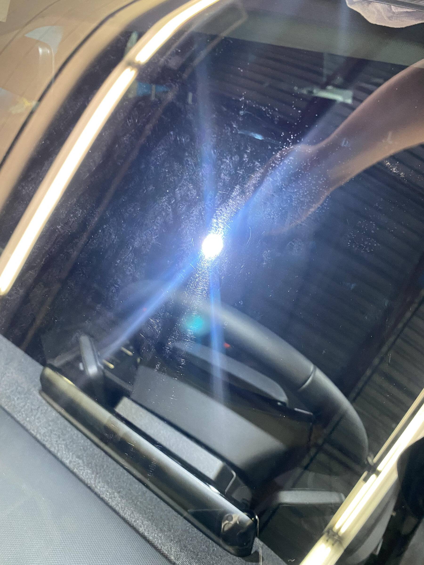

I tried this today but no luck :(
Did you rub it in thoroughly? When done, run water over it - does the water bead up, or does it sheet? If it beads up, it needs more rubbing. If the water runs off in a continuous sheet, then it should be clean. Is it a reflection, or something on the inside?
I looked at your pictures again, the second one look like what I have seen when rain repellent gets messed up. This took care of that issue for me. Take a look at the video on Amazon, they show how to use it.
Its not sheeting. I guess I need to rub it atleast 2-3 min with machine.

As my dad would say: Use a little more elbow grease! I did it by hand with the applicator that comes with it. Keep it moist with a spray bottle, and don't be afraid to rub too hard or too long when doing it by hand. You can feel the clean by the way the pad rubs.
Go to youtube and search for "invisible glass glass stripper". There are videos of people using it successfully. It will work if you use it as shown. keep at it until the rinse water sheets.

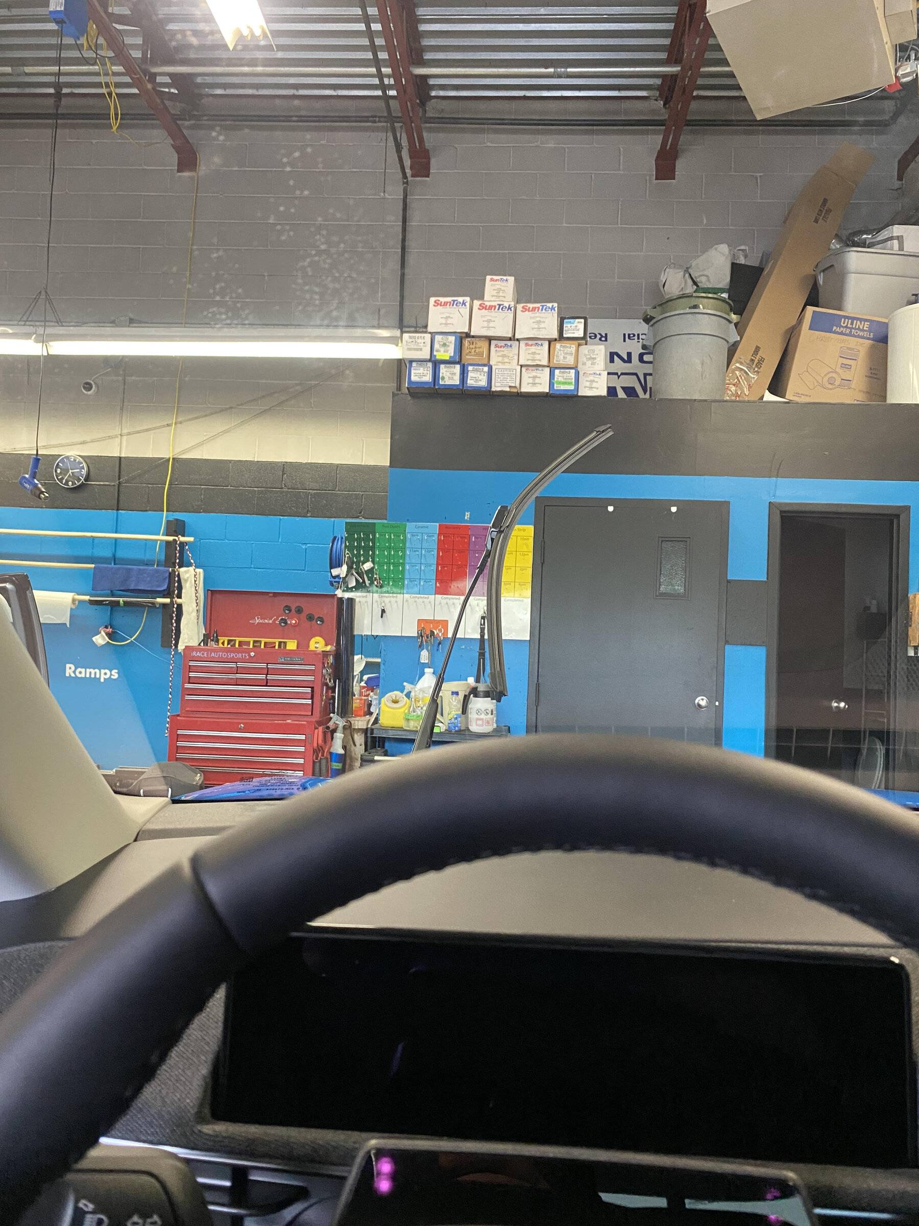

Hello People,
Has anyone come across some weird marks on the windshield?
Pictures attached.
Finally, it’s working with machine rub but taking so much time. I have to do 2-3 times for each stain. Each time needs to rub it for 3 min(not 100% but I can say 90% of stains are going away). Thank you so much!
Very good! Keep at it until it is 100% clean before adding new rain repellant. Be sure and follow the instructions when applying that, it looked like the previous coat was not properly done, which resulted in the stains. Been there, done that. I used to use Aquapel, but I used a ceramic coat on the glass on my current MME , same as I used on the paint. I think the aquapel worked a little better, but only lasted a couple of months, before needing to be removed and re-applied. I freshen up the ceramic coat with an SIO2 spray.

Hello People,
Pictures attached.
That looks like abrasive scratches from a cover cloth being pulled on and off. The windshield has a special coating for heat protection of the Sync 4.
