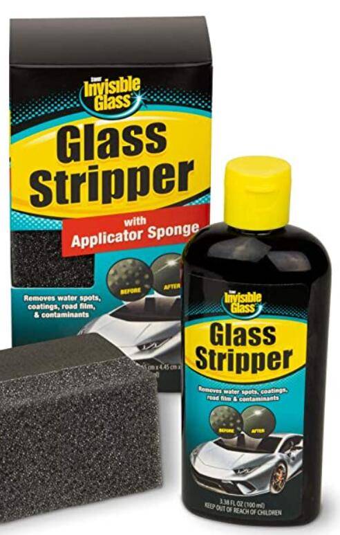

I just bought some Stoner (Invisible Glass) Glass stripper, that I plan to use to prep for putting a ceramic coat on my glass surfaces. It is actually a polish, and it is said to remove everything from glass, including ceramic and other window treatments, just add elbow grease.
Ford Mustang Mach-E Windshield Water Marks 1626652387081
I put Aquapel on my windshield shortly after I got the car, but it really hasn't worked as well as I have seen in the past with other cars. When I put glass cleaner on I see some kind of haziness while it is wet. I'm hoping the stripper will get it totally clean, then I will use isopropyl alcohol before putting the ceramic on. I see there are ceramic coatings specifically for glass, I'm still doing my research on that.
