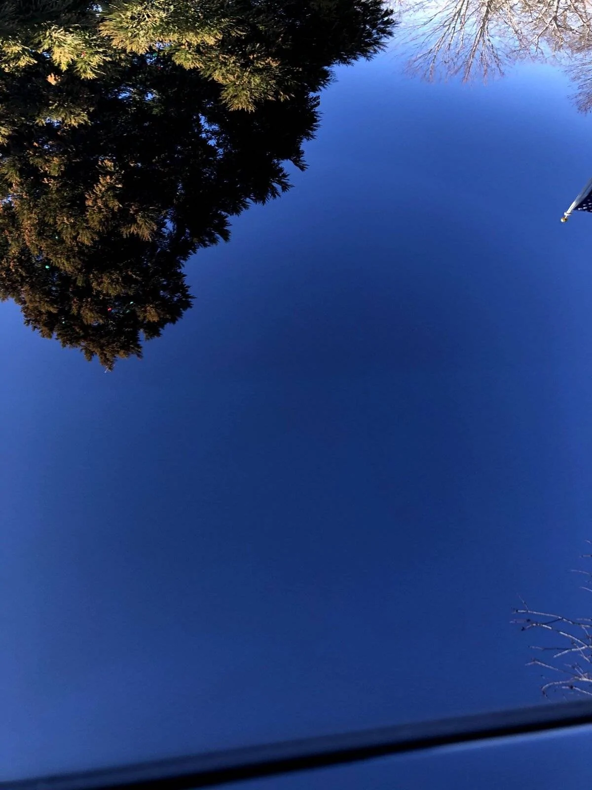

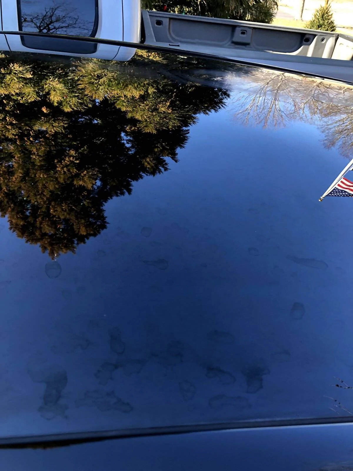

Okay, I'll bite: why would you not feel that Chemical Guys is a reputable brand? I've been using their products for a few years now and have been very happy. I had terrible water spots on the roof of our MME and the HD Water Spot remover followed by Jet Seal really did the trick.
Ford Mustang Mach-E Ugh... Water Spots! IMG_6759
Ford Mustang Mach-E Ugh... Water Spots! IMG_6760
