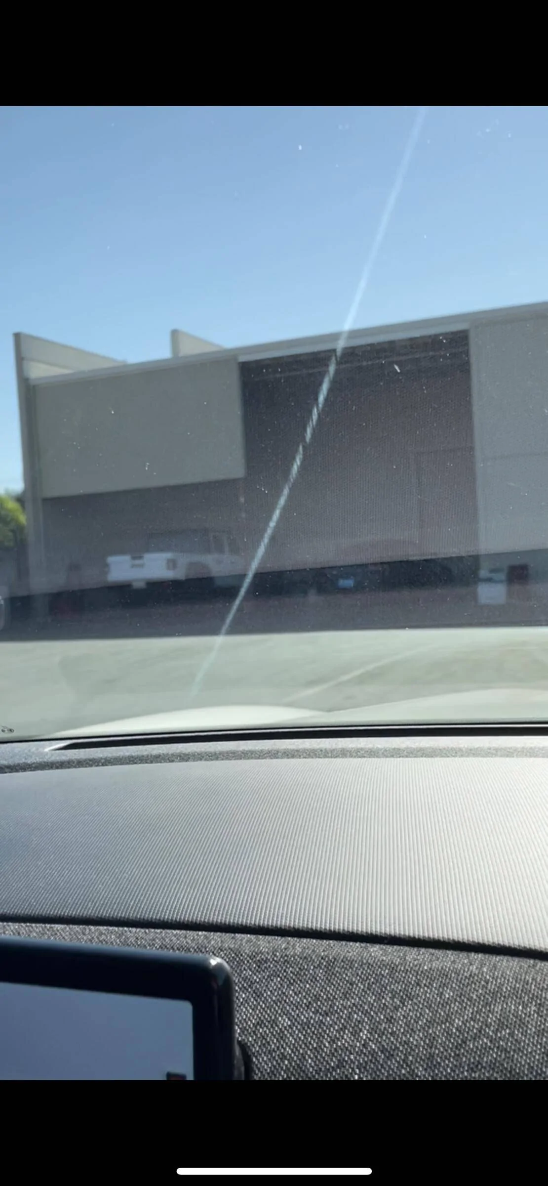

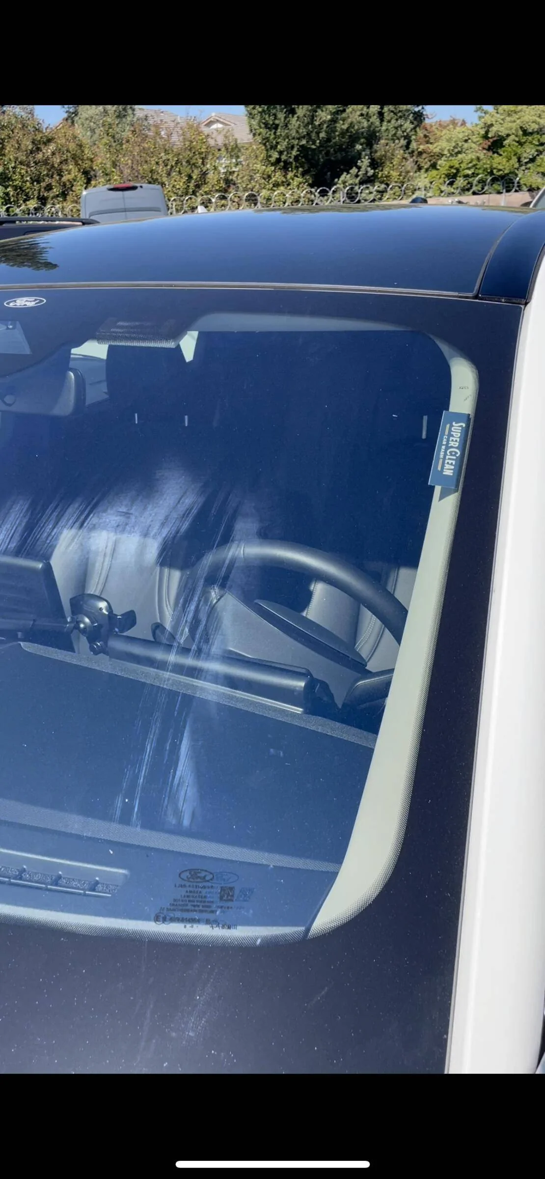

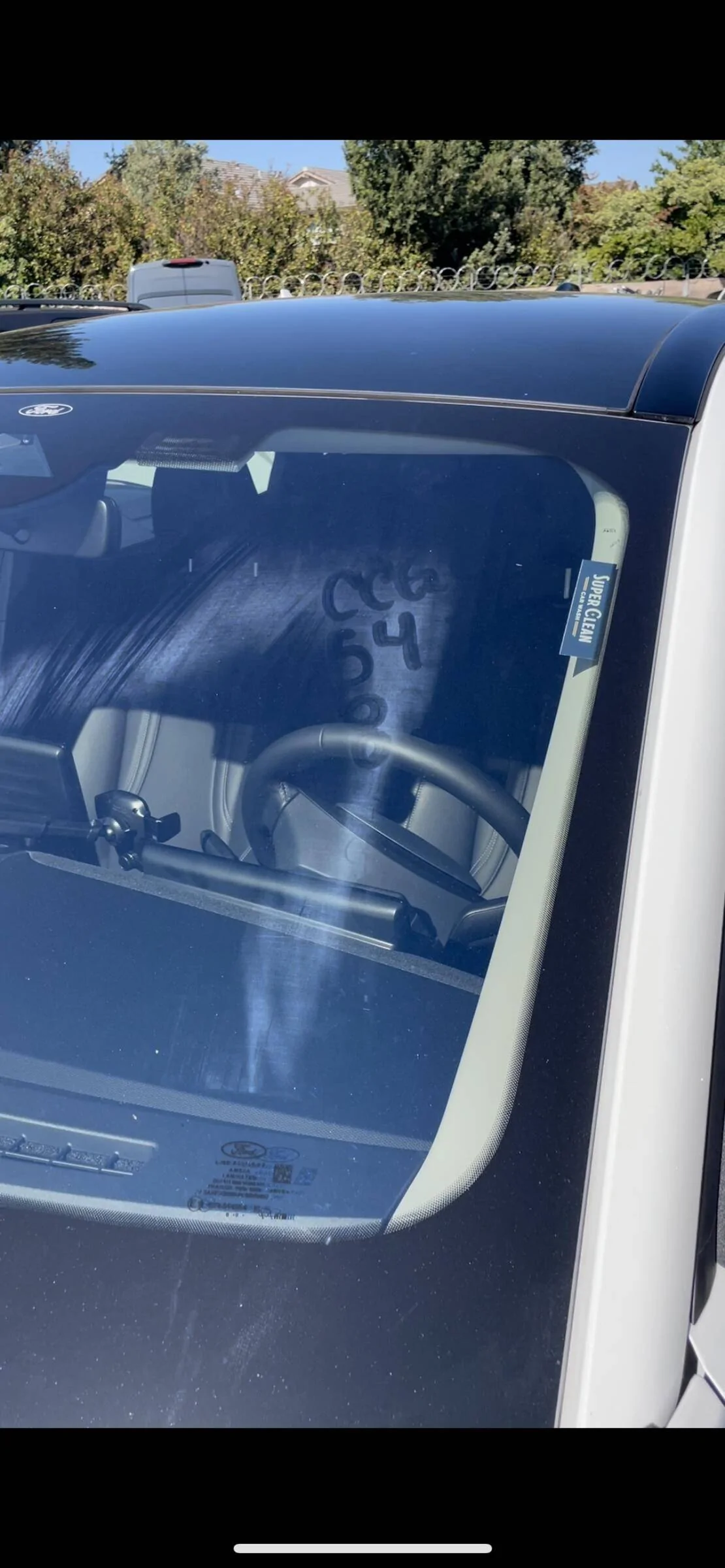

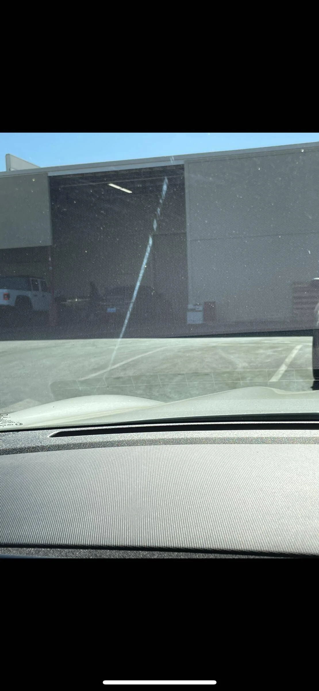

The markings have been on ours since day one.
The dealer tried to ‘buff’ it out but didn’t work. Ford refused to warranty it even though there are numbers written on it so obviously it was from some point in shipping, right?
The trail is where the wipers go, almost like someone turned them on with there being a ton of dirt on there. Think anything can remove it?

I went to dealer to show these stains and they told they will get back to me by next week
I sent video of the inside and outside, pictures etc. and warranty denied it. They said there was no way for them to prove it was a defect IN the glass.
We took delivery at night so there was really no way to notice it unless the sun is shining right in.
Hoping it breaks when they do the windshield/pano roof recall lol
same here , I Picked it up inthe evening. I didn’t noticed at all.. ceramic coating guy noticed it..
