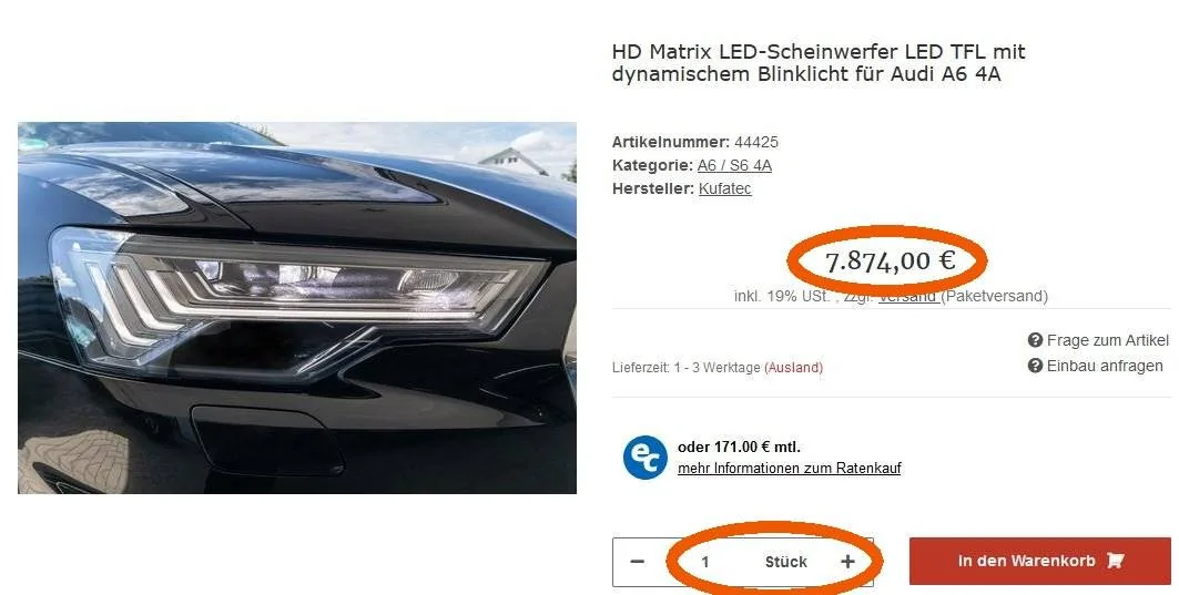

ok this is certainly not a Ford price category but for matrix LED head lights for the Audi A6
find the piece price below (it includs VAT).
It will not pay off to substitute current headlights by the matrix ones
currently you can convert 1:1 for a rough estimate
Ford Mustang Mach-E Matrix Headlights? matix
