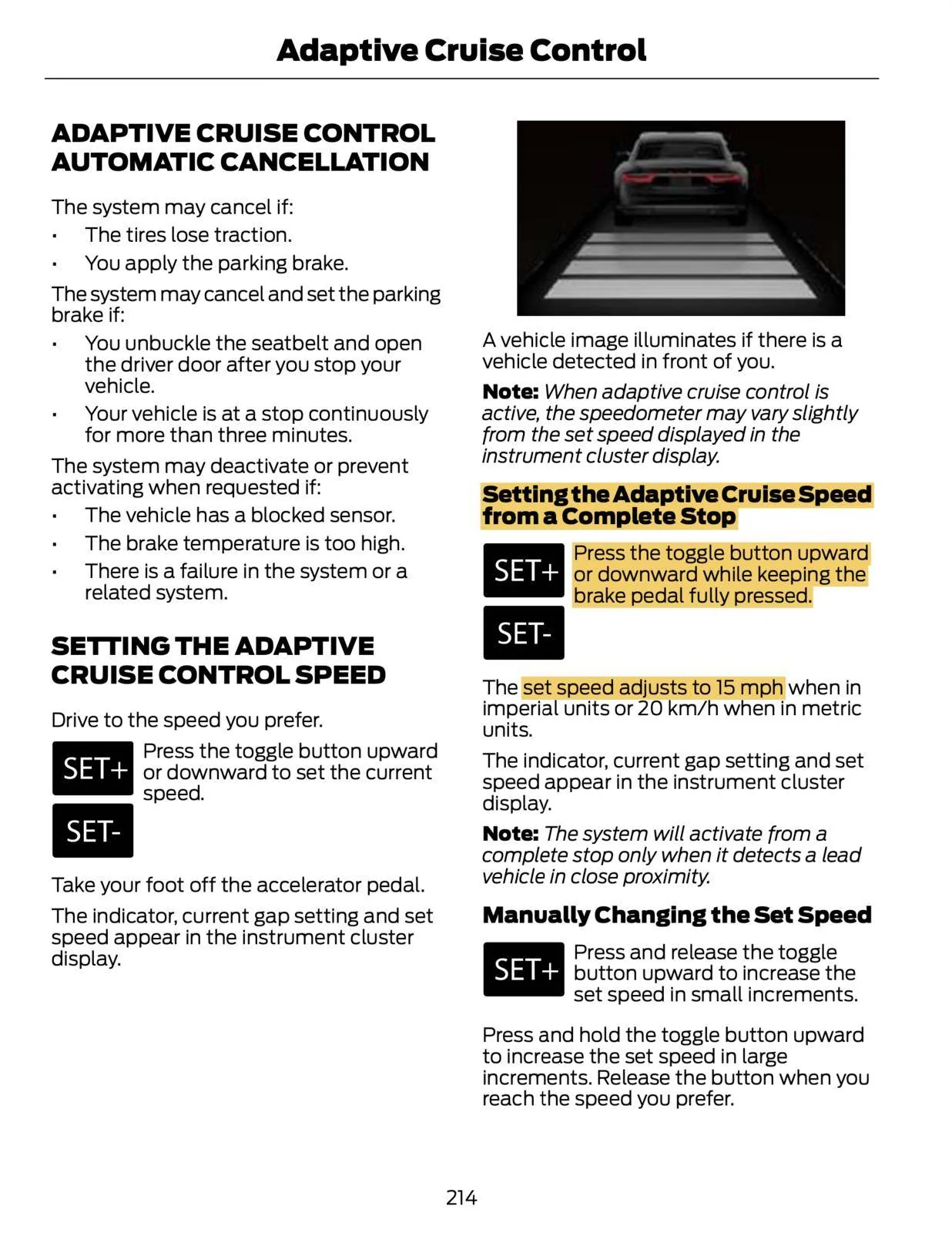

Just a reminder, the Owner's Manual is available on your phone using the FordPass app, in the car, and for download here:
https://www.macheforum.com/site/threads/2021-mach-e-user-manual-now-available.2052/
It takes less time to look something like this up in the pdf than it does to post yet another question answered in the manual.
Thanks for the info. I wanted to also get some real world perspective on system operation.
As we know, everything doesn't always work exactly the way the manual says it does. ;)

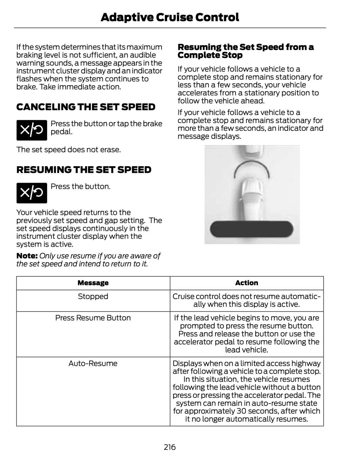

2 pages later
Ford Mustang Mach-E Minimum speed to set ACC/ICC? Screen Shot 2021-04-09 at 4.11.01 PM
Yes. It works like the manual says.
