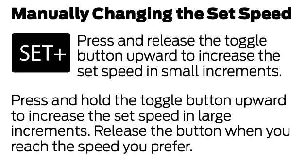

Thank you again, everyone. It turns out the fault is not with the car: the owners manual is vague. I just returned from my dealership where they explained that if you press and hold the speed set switch, the speed will increase by pre-set increments, the readout of which is in the upper right corner of the instrument panel. The owners manual implies that if you press and hold that switch, the speed will be set to the speed at which you release the switch--not exactly accurate. See attached.
Ford Mustang Mach-E "Manually Changing The Set Speed" malfunction? Screen Shot 2022-01-24 at 8.57.26 AM
You took it to the dealer for this? I'm actually surprised they knew the answer though

You are exactly correct, I've come to find out. Thank you. I wish the owners manual was that succinct!
