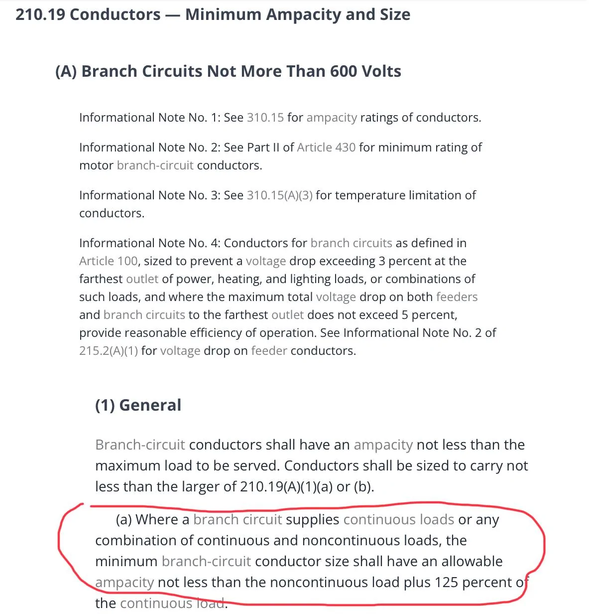

What's the reasoning for this 40Amp max on a 50amp breaker? I'd like to read more about it. My car can pull 48amps continuously on a 50 amp breaker without tripping it.
You should have a 60 amp circuit for 48 amp charging. Pulling a sustained 48 amp load on a 50 amp circuit is too much and is not in accordance with the EV home charging installation guides.
MBCook
Mar 20, 2022
396
628
2021 Mach E AWD ER, Infinite Metallic Blue
My understanding is it’s electrical codes. A 50A circuit is good for short/intermittent 50A loads. But if you pull 50A continuously (like charging overnight) it heats the wires that would be used with a 50A circuit more than is safe in the wall and becomes a fire risk.
Same reason you can have an 1800W microwave but a L1 charger can’t pull 1800W when charging your car. The microwave won’t be on for hours.
I believe the rule is 80% max amps for continuous use.
Ok that makes sense now that I'm looking at install guide for common EV Chargers, I have a lectron from china and the crappy installation guide never mentioned that :(. If I can get a return I will since I'm having other problems with it and get a Grizzl-e or a juicebox.
EDIT: Pulled down the charger and set it to 40 amps.
