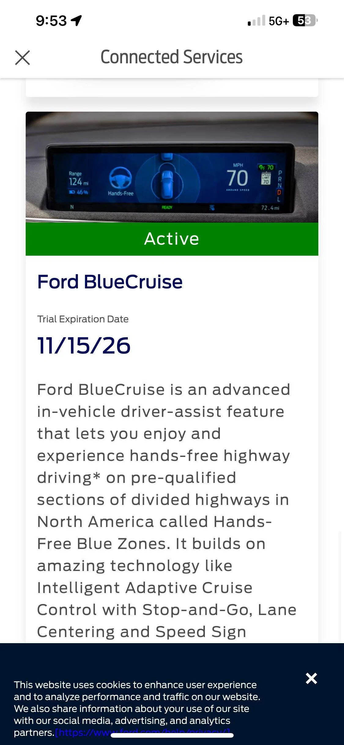

Hi y'all. I created an account here because I'm experiencing the same issue on my Mach-E Select that's less than 2 month old and need help :(
My question is- when you pull out the 21/22 fuse to reset the modem, are you pulling it from the frunk fuse box or the passenger side cabin box? Also, are you disconnecting the 12v battery as well?
The guys at the Ford dealer told me that the communications module is on nationwide backorder and no clue when mine will arrive. I don't want to wait potentially months! I told him I read about the 21/22 fuse on a forum and he just said he wouldn't go yanking fuses out of my car :rolleyes:

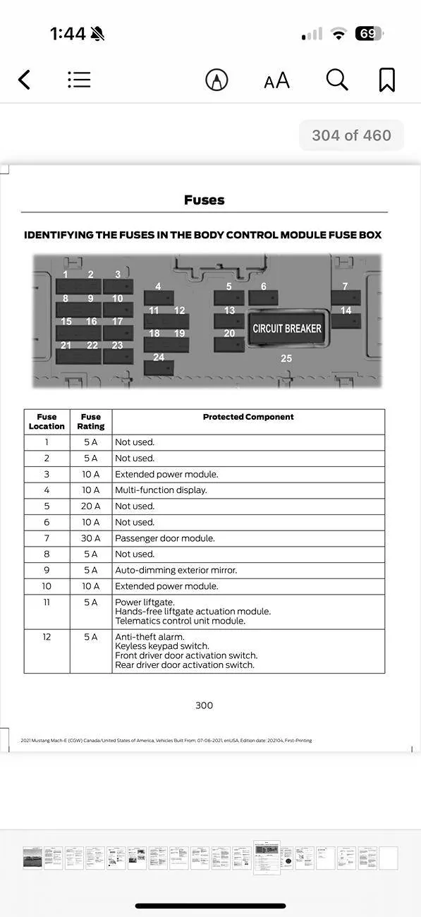

The TCU is on fuse #11, so it would be the 11/12 fuse that you pull if the GWM doesn’t solve it. Remember to wait a minute or so before plugging it back in. ??

To be clear: You're saying BC does not work? Did BC work at some point and then stopped working, or it has never worked at all?
BC always used to work before. The first trial expired and then they called me earlier this year for a 1 month free trial so I signed up for that and it worked fine during that 1 month. When that trial expired though I lost BC. I subscribed later at a discounted rate and ever since I resubscribed it has not worked. It's the handsfree that doesn't work. When you press the button, it claims it's entering into BC but even in sections of highway I know has handsfree, it never enters into handsfree mode anymore. So sounds like maybe a different issue than this thread is about.
Bluecruise was not working, neither was the Ford app (information would not update over 2 weeks). After pulling the 21/22 fuse and putting it back in, Bluecruise and the app both work 100% again.
