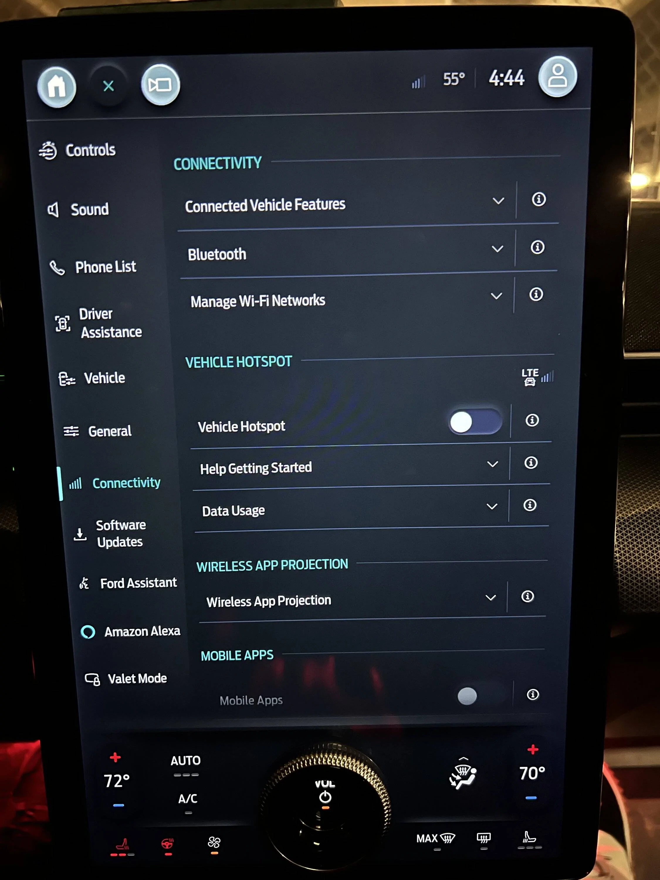

My screen does not look like that....Connected Vehicle Features arrow does not drop down the list yours shows.
That’s just an old screenshot I got from another thread here.
The screen has changed a few times.
The fact that the dropdown doesn’t show the setting is a problem.

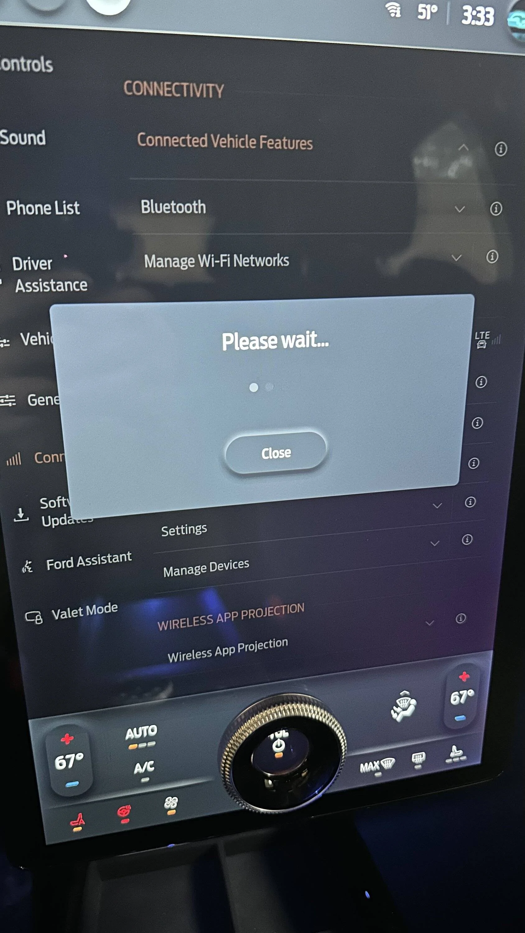

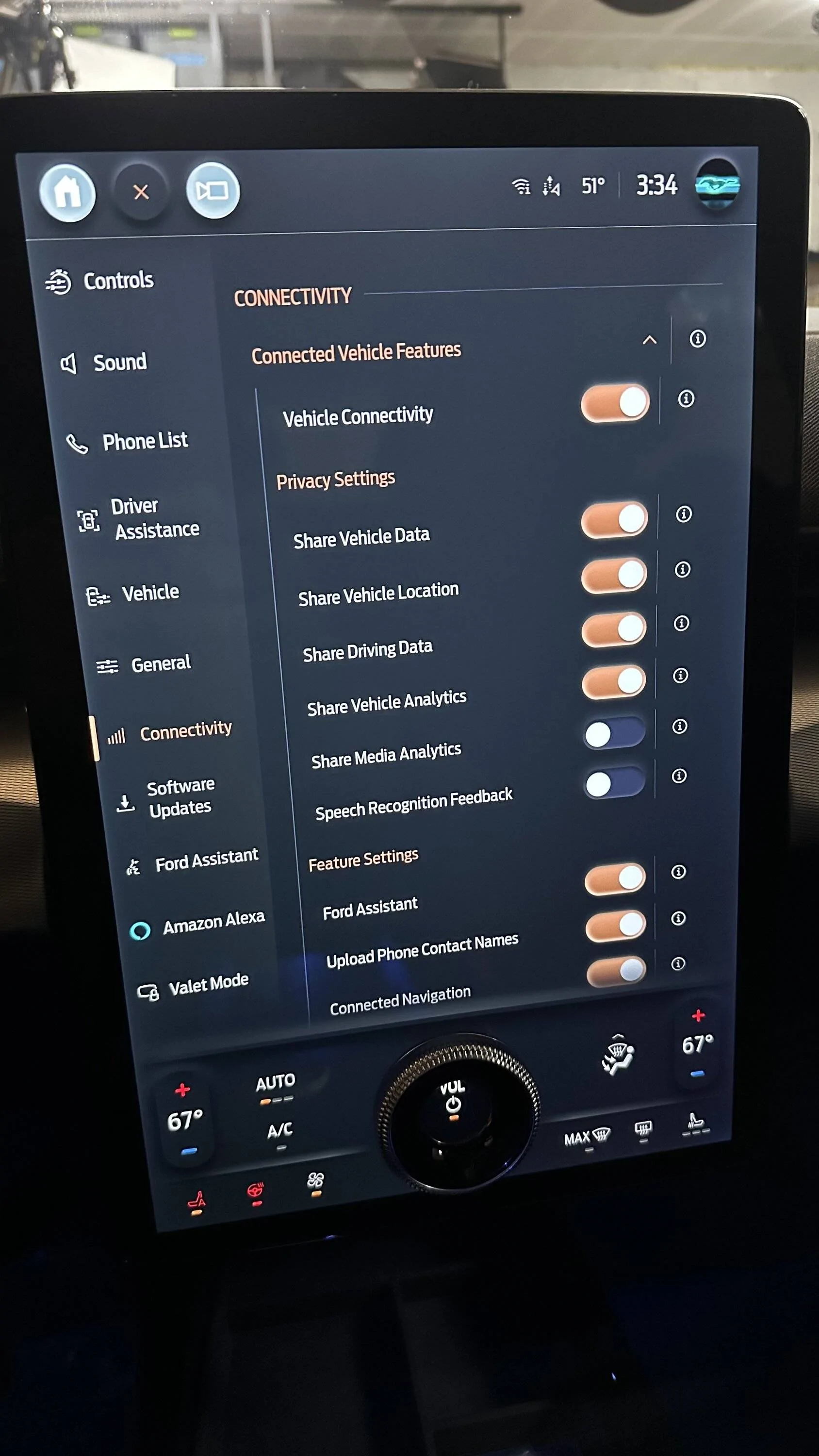

I went in my car and got the same thing as you. It said Please Wait, and then nothing.
I did a sync reboot and then I showed up again.

Thx for that Ali. What steps did you take for the Sync reboot exactly. Just trying to avoid a factory reset. ??
alexgorod
Alex
Jul 27, 2021
1,304
1,400
DBA
holding the seek right and volume down buttons on the steering wheel will reboot the Sync.

Sync reset failed to solve the issue, I did it twice...same problems, no connected features dropdown, no wifi networks when I'm in front of a building with at least 50 apartments, no bluecrusie, same ol same ol. I'd bet it's a bad modem. Cannot do remote start, cannot get updated app battery info, spinning software update into oblivion. Off to service tomorrrow.

I read a forum post yesterday that mentioned pulling the 21/22 fuse. Guess what??? It worked. All my connected services came back online. Hoping I get software updates now but the Update Now button was grayed out. At least it's not appearing to be a bad TCU. Shouldn't dealers know this? No one had a clue at the dealership, I actually texted the service tech yesterday to tell him.
