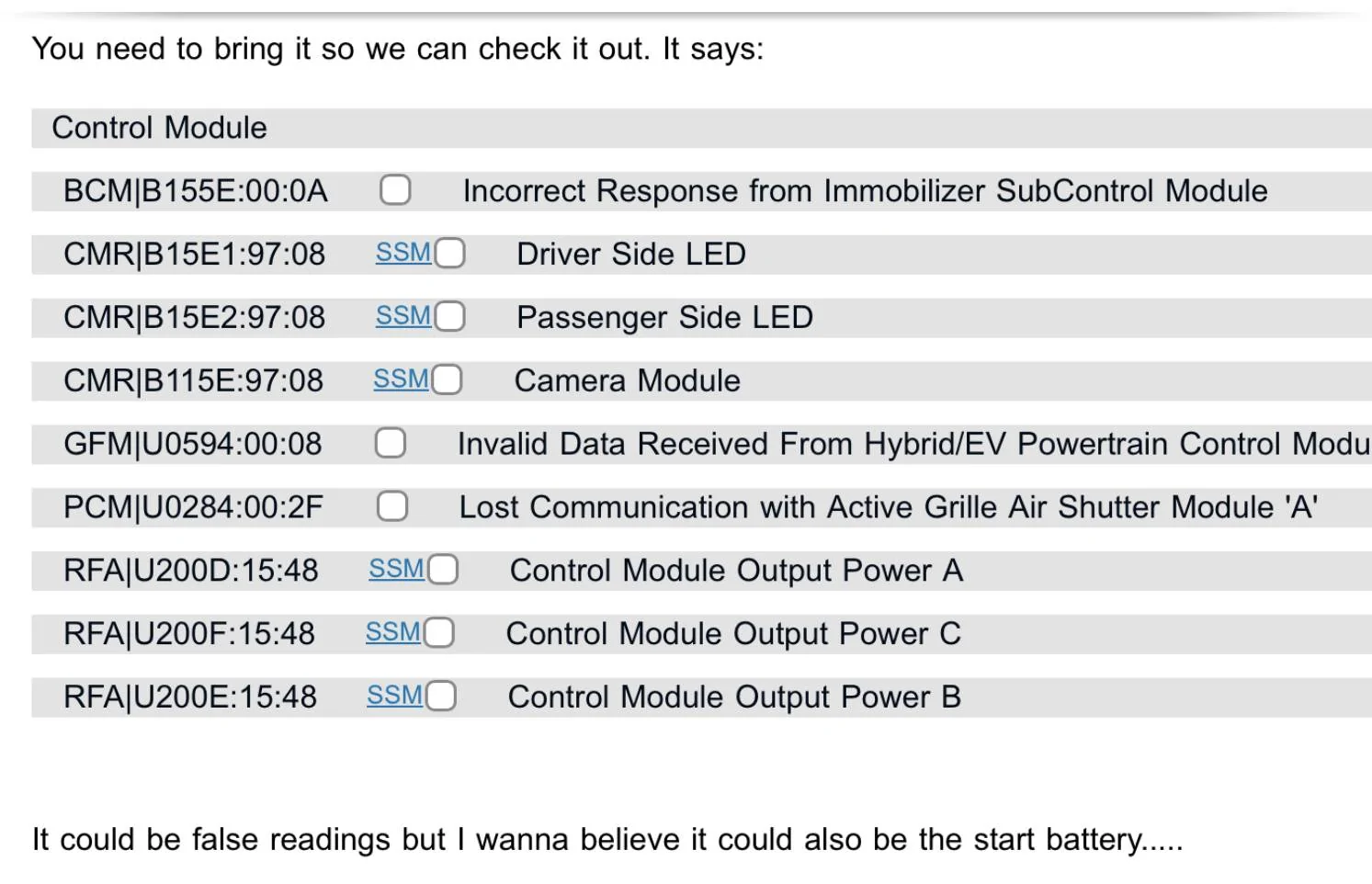

the codes the dealer sent me was but not sure they are relevant to this issue.

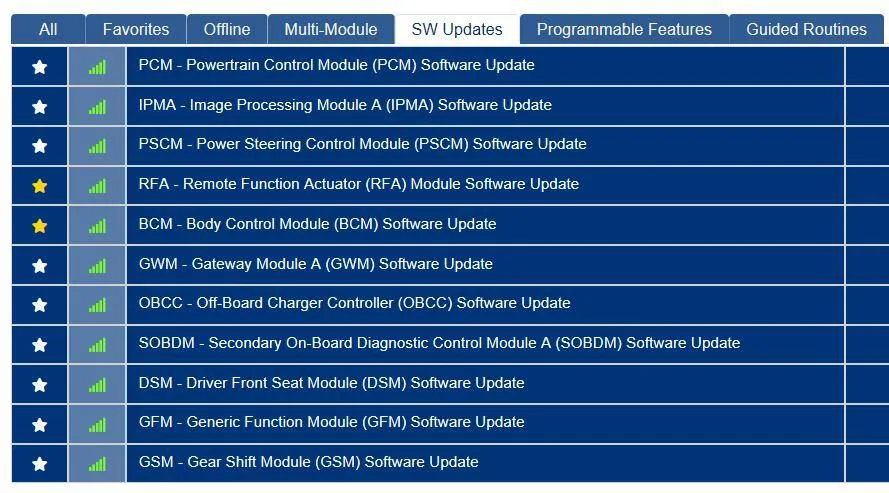

Turning off welcome lighting should help with that. Otherwise you need to get the BCM and RFA modules updated to fix the "waking up" issues. I see you have a few updates:
Ford Mustang Mach-E Monitor your 12Volt battery 1678330389692
Note: The GFM update should be done at the same time as the BCM update. Afterwards they can enable the frunk release button on the screen:
Ford Mustang Mach-E Monitor your 12Volt battery 1678330577005

Don’t know what the GFM update will do , thanks for the tips.
the frunk and trunk buttons already show up as I have updates thru 4.1.3
GFM is the frunk module. That and the BCM need to be updated together otherwise you'll get a warning message every time you start the car.
Interesting that I have the button and I just checked that it works. Not on the main screen but 1 level in , on the mode page
