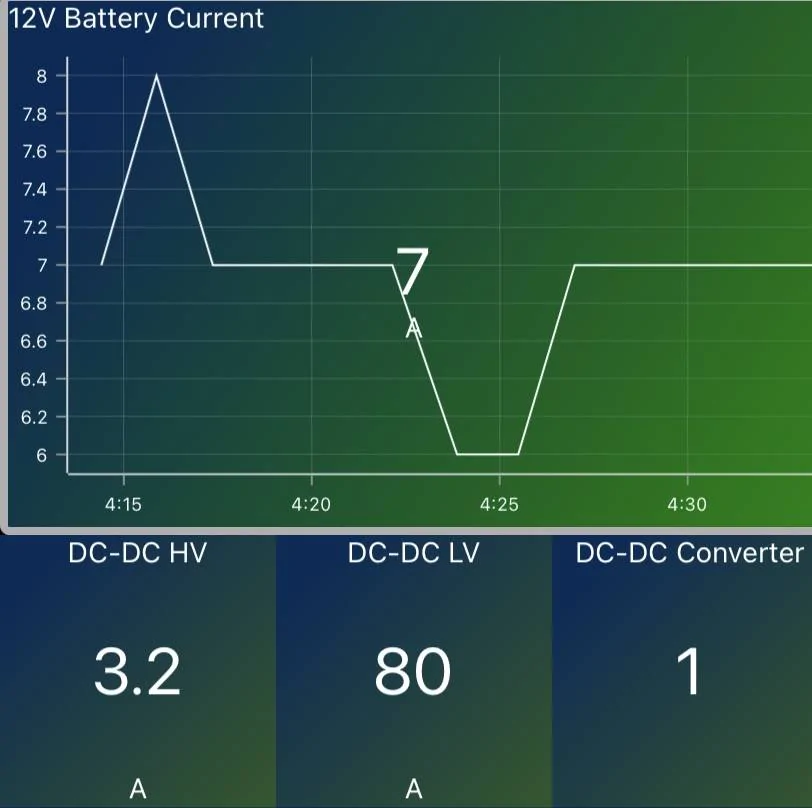

I’ve never been able to I understand the difference in these readings. 12V Battery Current is what I understand to be the draw from the LV battery. But there are others.
For DC-DC HV, is it showing current that is leaving the HVB to charge the LVB? Also don’t understand what DC-DC LV is measuring. I was thinking maybe that is current coming from the HVB and stepped down to 12v to run accessories. But not sure What the 12v battery current sensor is showing then.
