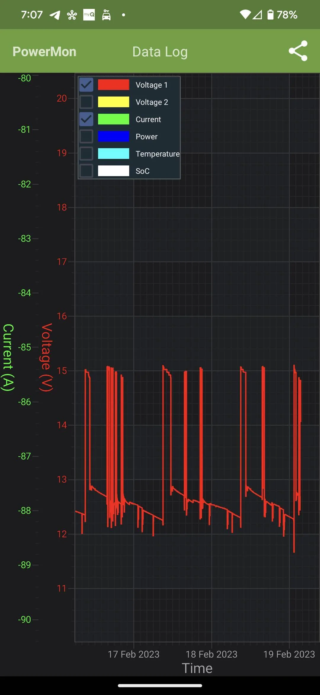

I received a low voltage warning again and checked the battery and it was at 12.8 volts. I decided to charge it and of course hasd to take the car apart and then clamp on to the strange positve pole and the ground and I see with my BattteryMinder that the battery is weak and it is desulfating it wiith charging to follow. So we will see what 12 hours of charging does for it. From what I can see the positive pole of the battery is buried in the battery box and that U shaped thing is just a connection for clamps but defeats putting a BatteryMinder on with normal terminals with out removing the frunk.
I think you're over thinking this whole thing.
1 - If you haven't charged the car in weeks it's completely normal for the DC/DC inverter to engage to top off the 12v LVB from the HVB. Especially if the drives were just short trips.
2 - The LVB will discharge with accessories connected, OBDII dongles connected or just by walking by the car many times triggering the welcome lighting.
3 - Taking the current voltage really means nothing. The LVB goes through huge swings in voltage throughout a day. At one point in time it really doesn't mean anything. That being said, 12.8v, from my logging, is actually on the high end of normal for an inactive state.
4 - The driver's side panel is all you need to remove. You have both the neg and pos terminals right there, you don't need to get to the actual battery.
5 - If you want easier access to those terminals for less than $5 go here: https://www.macheforum.com/site/threads/guide-better-jump-point-access-battery-access.10976/
6 - The message, in of itself, is actually a good thing if the conditions exist that would cause it to trigger, which it sounds like they exist in your case. This means that the car is doing what it's supposed to do.
Here's an example of the voltage swings in the LVB:
Ford Mustang Mach-E Monitor your 12Volt battery Screenshot_20230219-190751

Your battery is not at 14.4 V that is when it is on and charging it? You need to shut it down open the door and close it to see the 12V voltage. Now I see 15.2 V charging a lot and normally I see it around the 12.3 V when reading the battery after power off on the 12V plug in. You can tell it may be low by how the door pops I have found. An OBD2 is the best tool to read the 12V.
You can see it go up to 15V to charge the 12V pretty easy on that graph. It should look after itself and we never hear from it. This winter it is surviving ?. New mode that comes on now preparing for drive is shown in ford pass but it is auto. 1 to 2 times a day for 15 20 minutes. Hear the recirc pump and maybe thawing out the contact? It has made a few -30F this winter in which the 12V would not have survived last. Things are improving here. Get departure scheduling working and happy camper.
