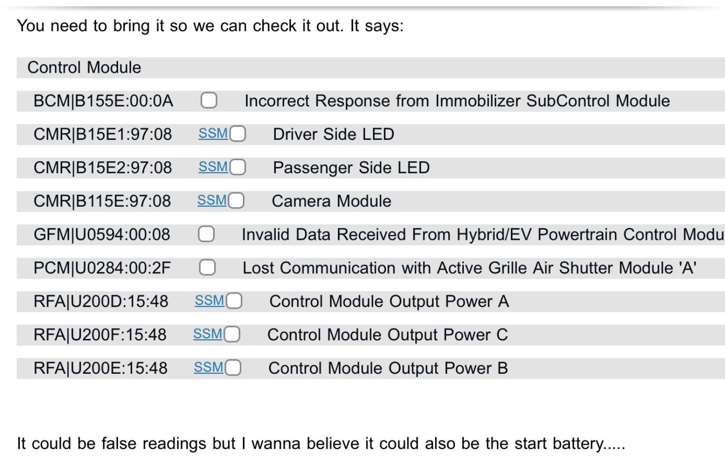

my wife drove the car today and it happened again when she started the car. I called the local dealer and they checked the car and said to bring it in, see below
will bring it in either tomorrow or Thursday.
I have checked the car with the meter some of you have and seems a touch low, time to time but overall it works. Hopefully they just have to reset some codes.

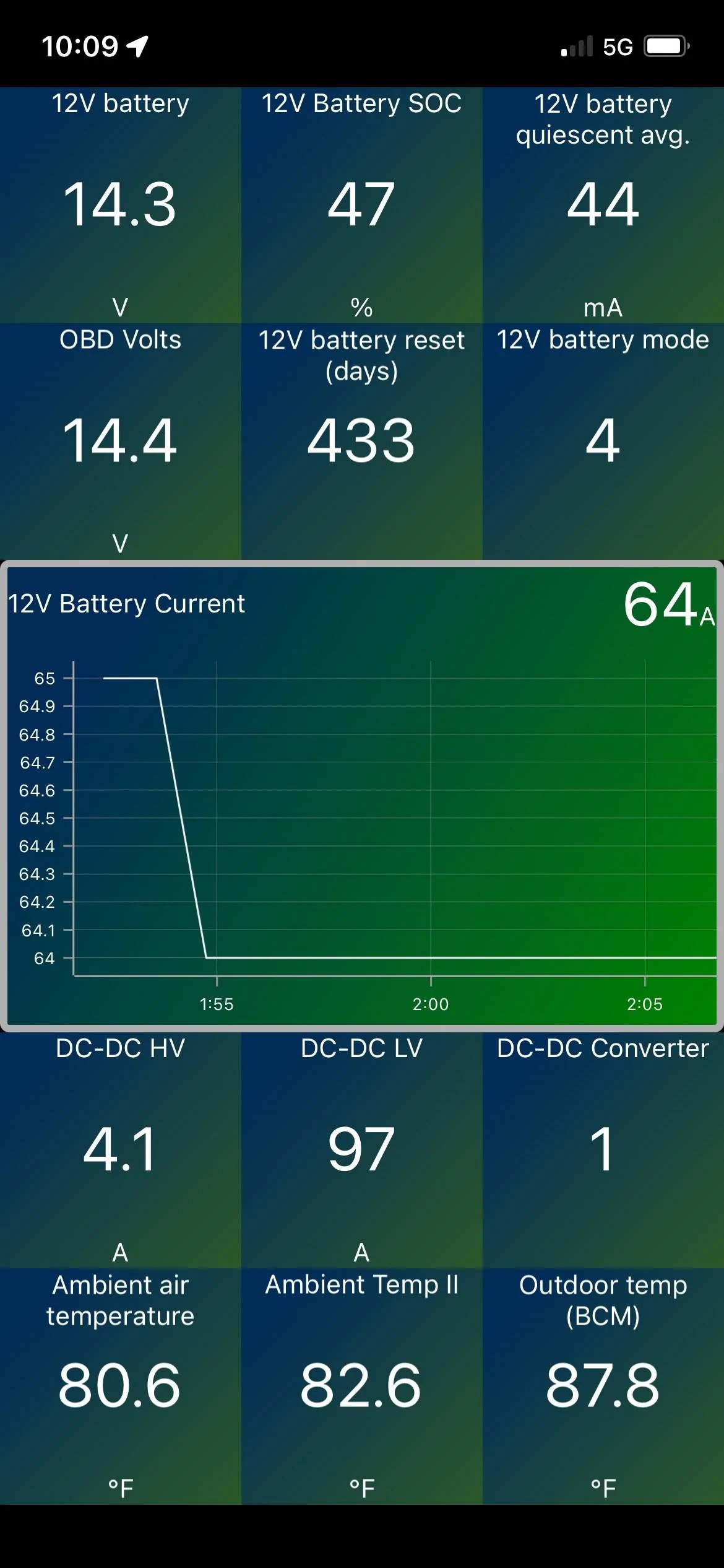

Does anyone think this is an issue, car was used yesterday . 12V battery SOC 47%
Wow, those are almost identical numbers to what I got. The other day I was at like 74% didn’t really drive then the next day it was at 47%. Today I am also at 45mA quiescent drain.
First time I’ve ever seen the main screen be black and have a message about the system turned off to save energy. Car still started just fine but I’m concerned what this deep cycling is doing to the LVB.
I had the same thing on the main screen, turned off to save energy. I thought my wife might not have turned the car off yesterday.

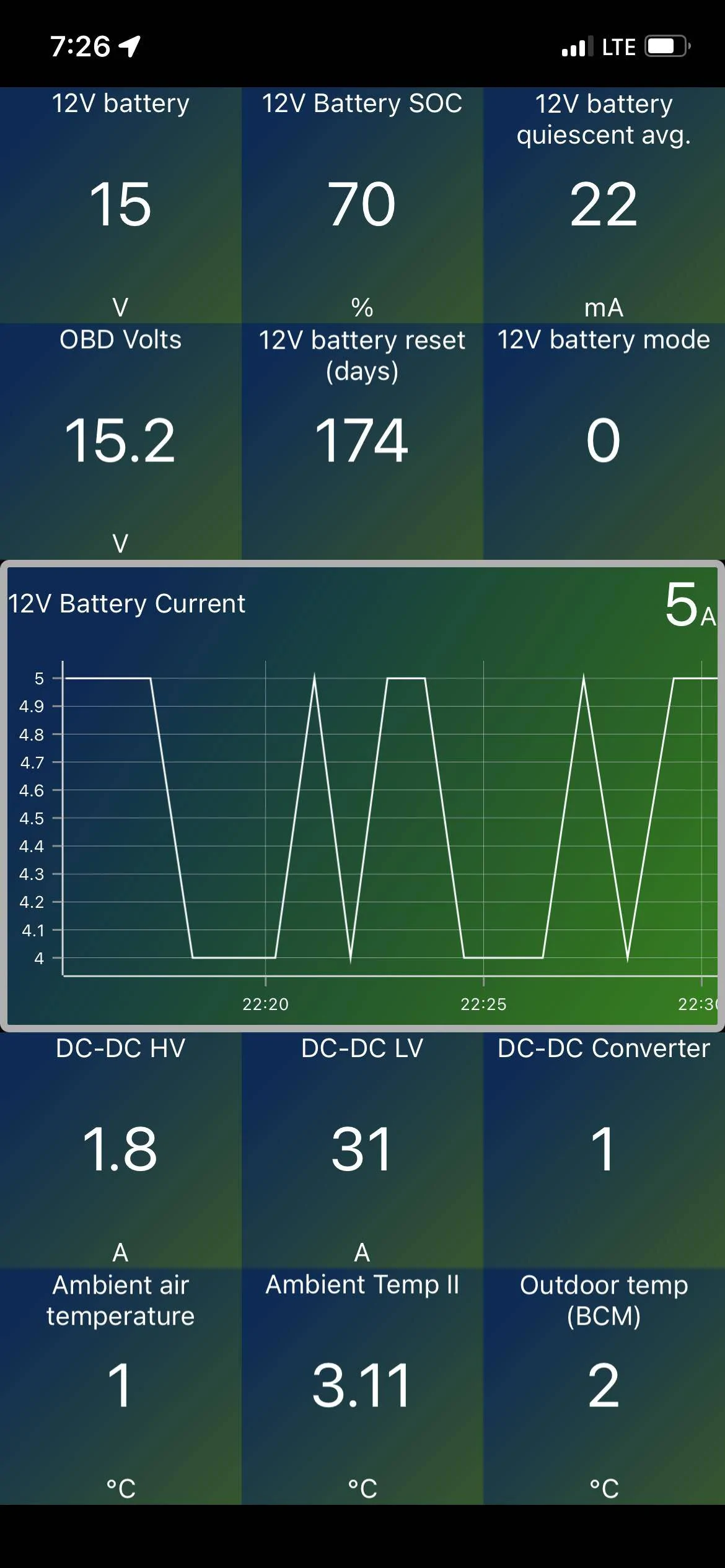

My car is at 70% after sitting for 3 days. That's a high key-off drain. Should be in the 20's like mine:
Guess I do have an issue, what are the chances that they will actually be able to find anything,
I have no add ins or anything although I do leave a couple of USB cords plugged in but those lights shut off in a couple of minutes
I used the car today several times and got the battery SOC up to 88%.
just went out to the car and it is 77% and quiescent is 43 Ma.
Last time the car was driven was at 4:30 for 20-30 minutes

Turn off welcome lighting and change your FordPass password to block prior 3rd party apps. Those are the usual suspects.
I don't think the dealer is going to help you much here, they'll just want to change your 12V battery and you'll still have the drain afterwards. You really have no relevant codes. The only one of concern is the active grille shutters, they could fix that at least.

I don’t t have any 3rd party apps that I am aware of. No utility company integration. The welcome lighting goes off after 5 seconds, or thereabouts, so not sure how that will make a difference but I will try.
the codes the dealer sent me was but not sure they are relevant to this issue.
