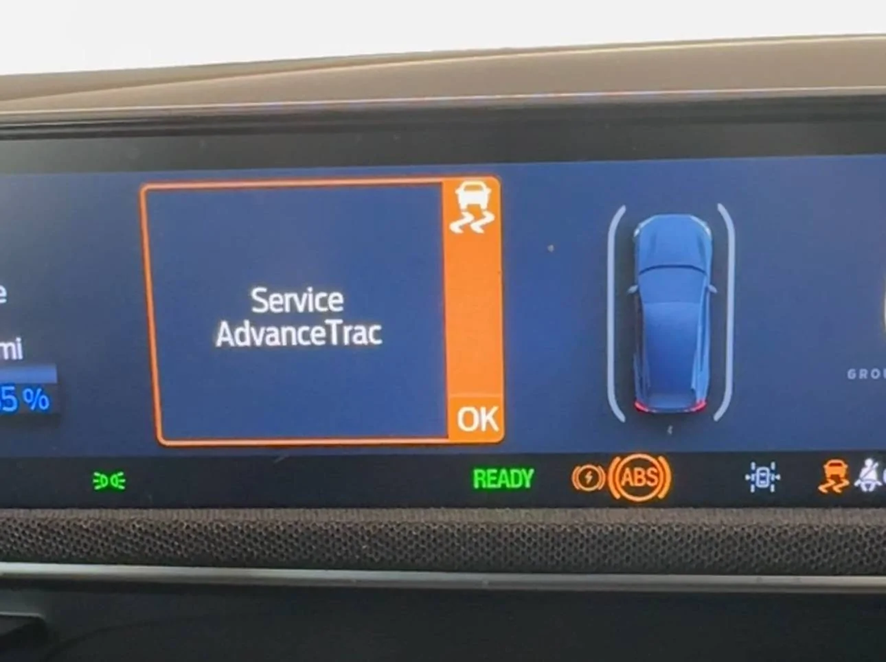

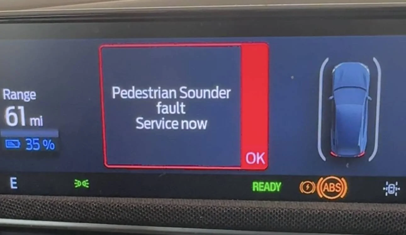

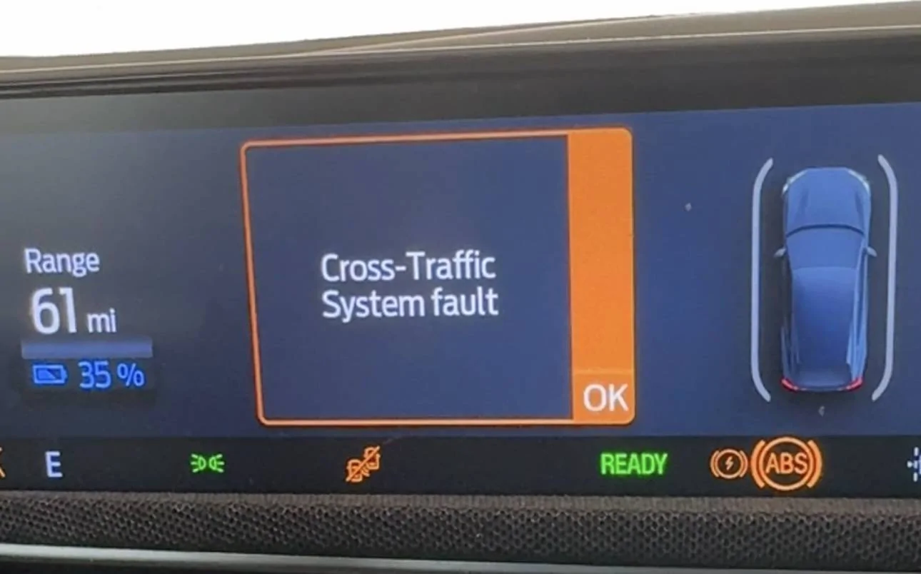

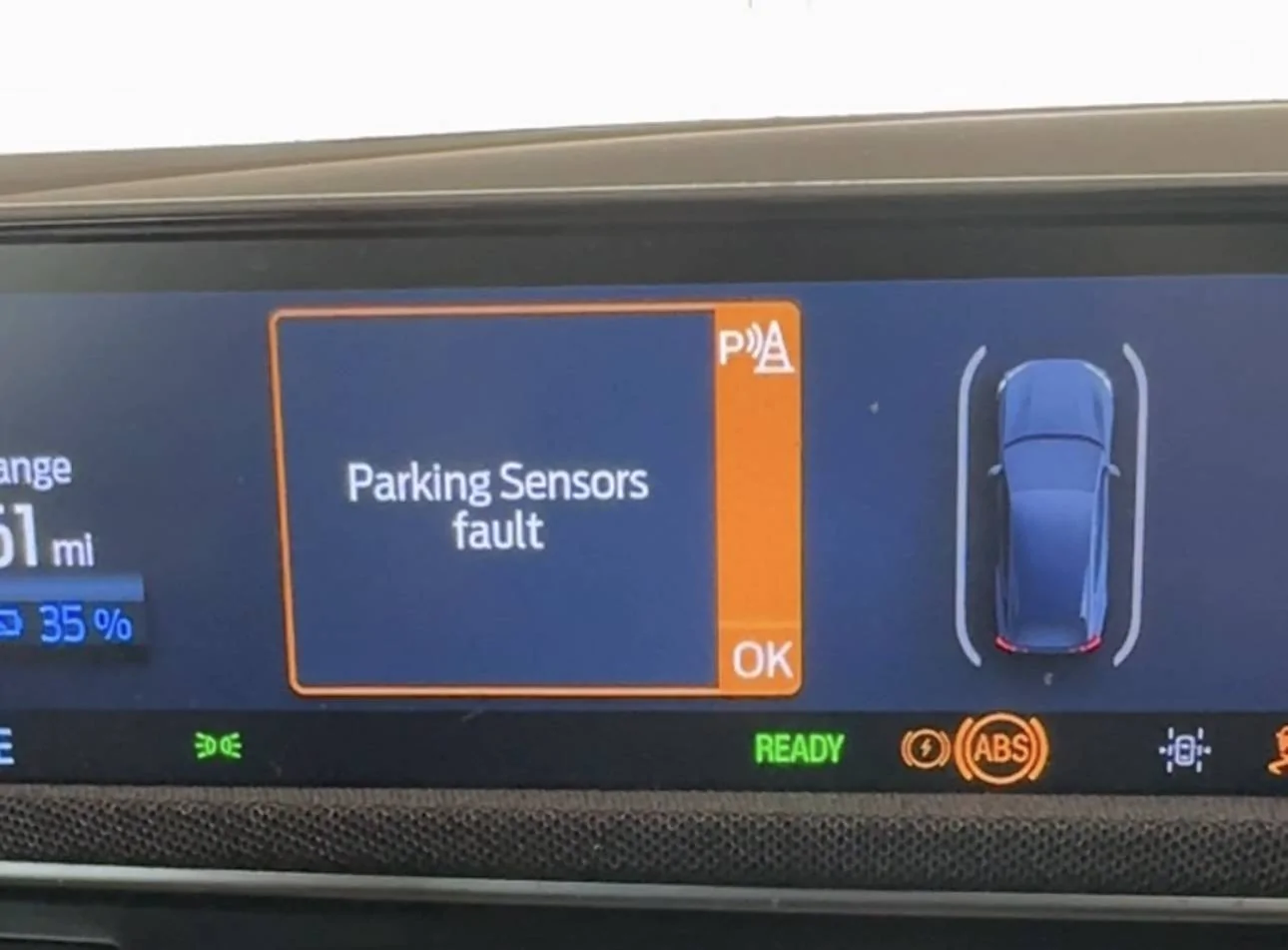

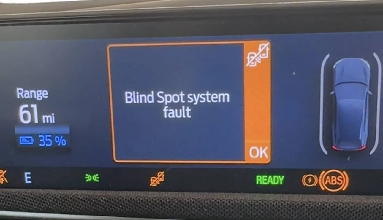

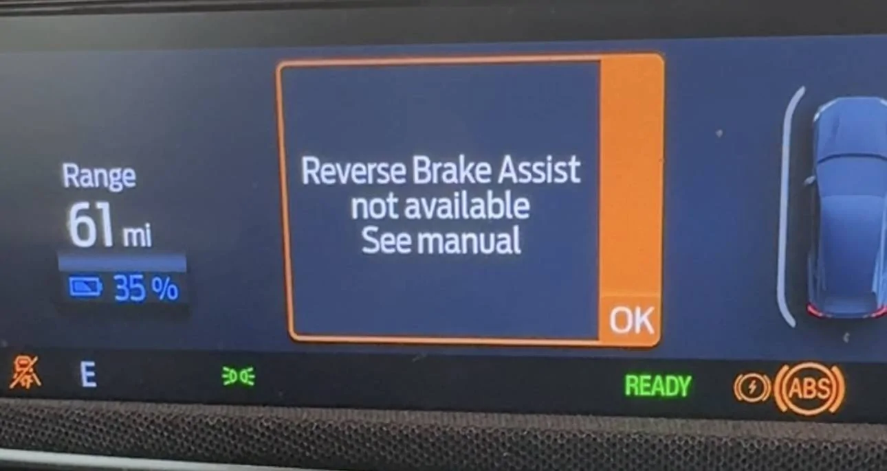

Hello Mach e Forum,
I have a 2021 Mach e Premium with 20,000 miles. I love my Mach e and have had a lot of fun driving it.

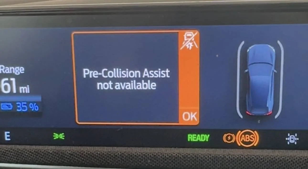

Today while driving, I started getting multiple error messages pop up on screen:
1. Pedestrian sounder fault - service now
2. Service AdvanceTrac
3. Parking sensors fault
4. Pre-Collision assist not available
5. Cross-Traffic system fault
6. Blind Spot system fault
7. Reverse Brake Assist not available - see manual
8. Advanced front lighting features temporarily unavailable
In addition, I have:
a. ABS - lit up on screen
b. Driving mode - can’t select any of Unbridled, Engage or Whisper
c. Steering seems tight
All these happened today, within a 2 minute stretch and now continue to pop up.
I tried a hard reset / Factory Reset, but it has not solved the issue.
I am looking for any suggestions to resolve the issue.
Please help. Thanks in advance. ??????

Hi there, I have had similar message come up this evening and my car will not drive. I also get the "Stop safely now" message. Just wondering if you were able to fix your issue on your own or if you had to bring it in. I think I'll have to have mine towed. Thanks in advance!

me too tonight and also 'errors' with the doors, frunk, pedestrian sounder - car is in a parking lot dead!

I had these messages pop up when driving and at the same time the ECG update was being down loaded. At a stop light I shut the car off and back on and they all disappeared and everything was back to normal. Update installed and no further issues.

OH2AZ2OH = thank you. It was in fact the 12v had to have ford roadside assistance jump the car so i could ride it to the dealer.
13,022
17,567
Multiple unrelated errors are a symptom of the 12V battery losing its ability to keep the car’s electronics afloat. Replace your 12V battery before you cannot get into the car. ??
