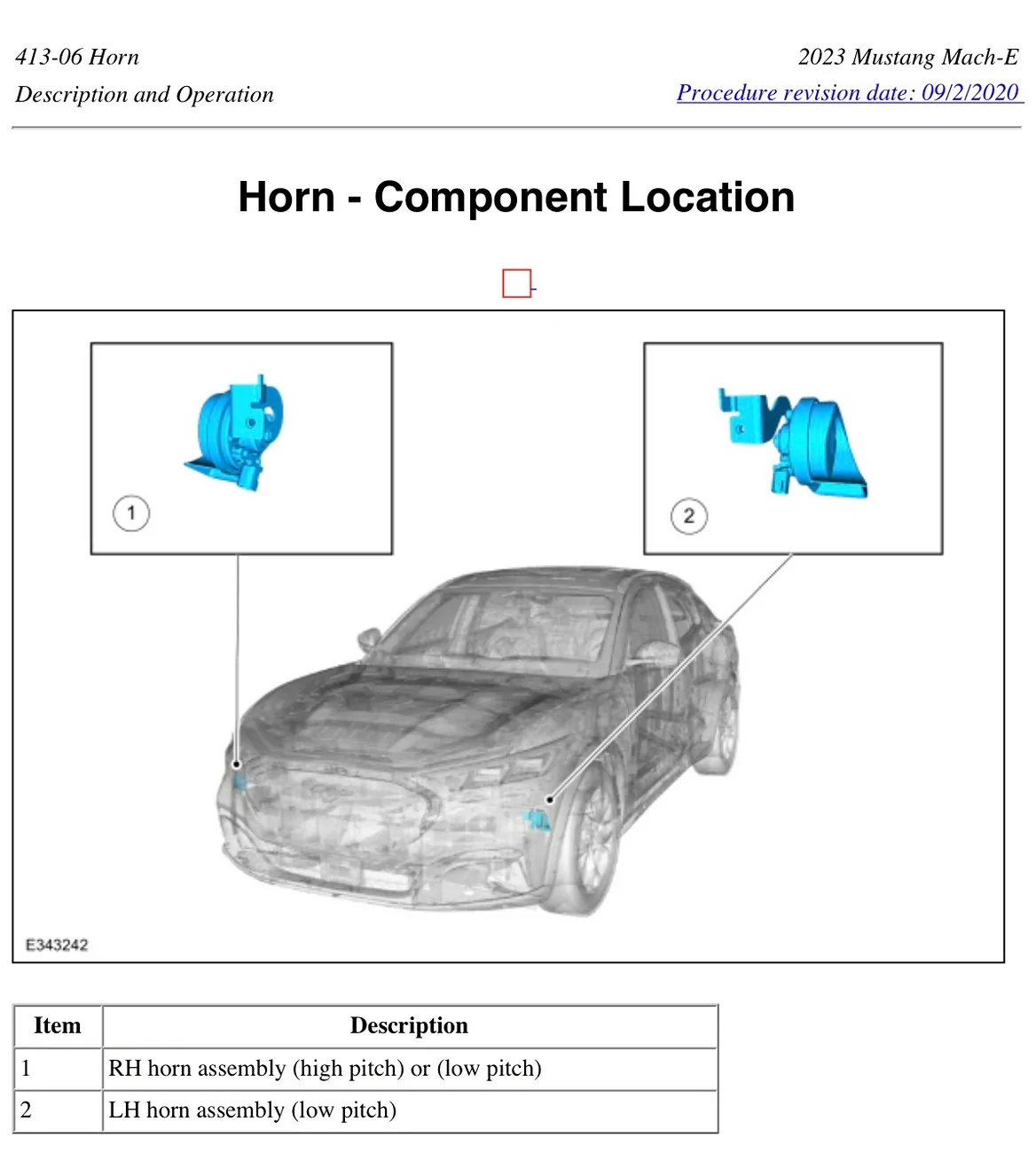

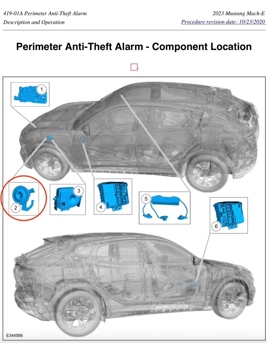

What many are unaware of is there are three horns. There are the traditional high and low pitch horns, then there is the separate alarm horn. The alarm horn is weaker sounding than the normal horns.
The normal high and low pitch horns are located behind the front lower section of the fenders left and right. The alarm horn is located behind the left fender at the top.
Part numbers in case anyone interested are:
Left horn: LJ9Z-13832-C
Right horn: LJ9Z-13801-A
Alarm horn: LJ9Z-13832-B
Normal horns location:
Ford Mustang Mach-E Mustang Mach-E Horn Screenshot 2025-08-13 at 3.55.01 AM
Alarm horn location:
Ford Mustang Mach-E Mustang Mach-E Horn Screenshot 2025-08-13 at 3.56.31 AM
