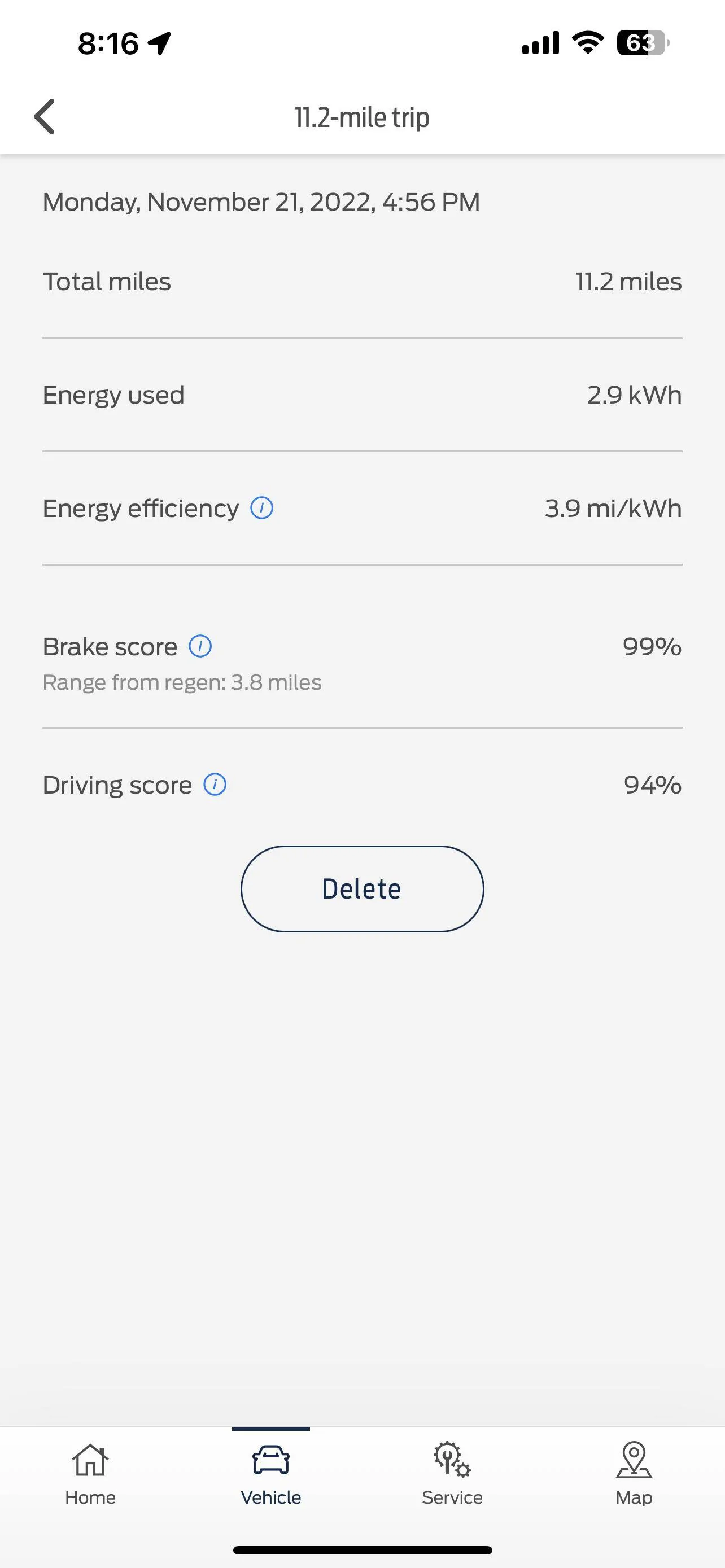

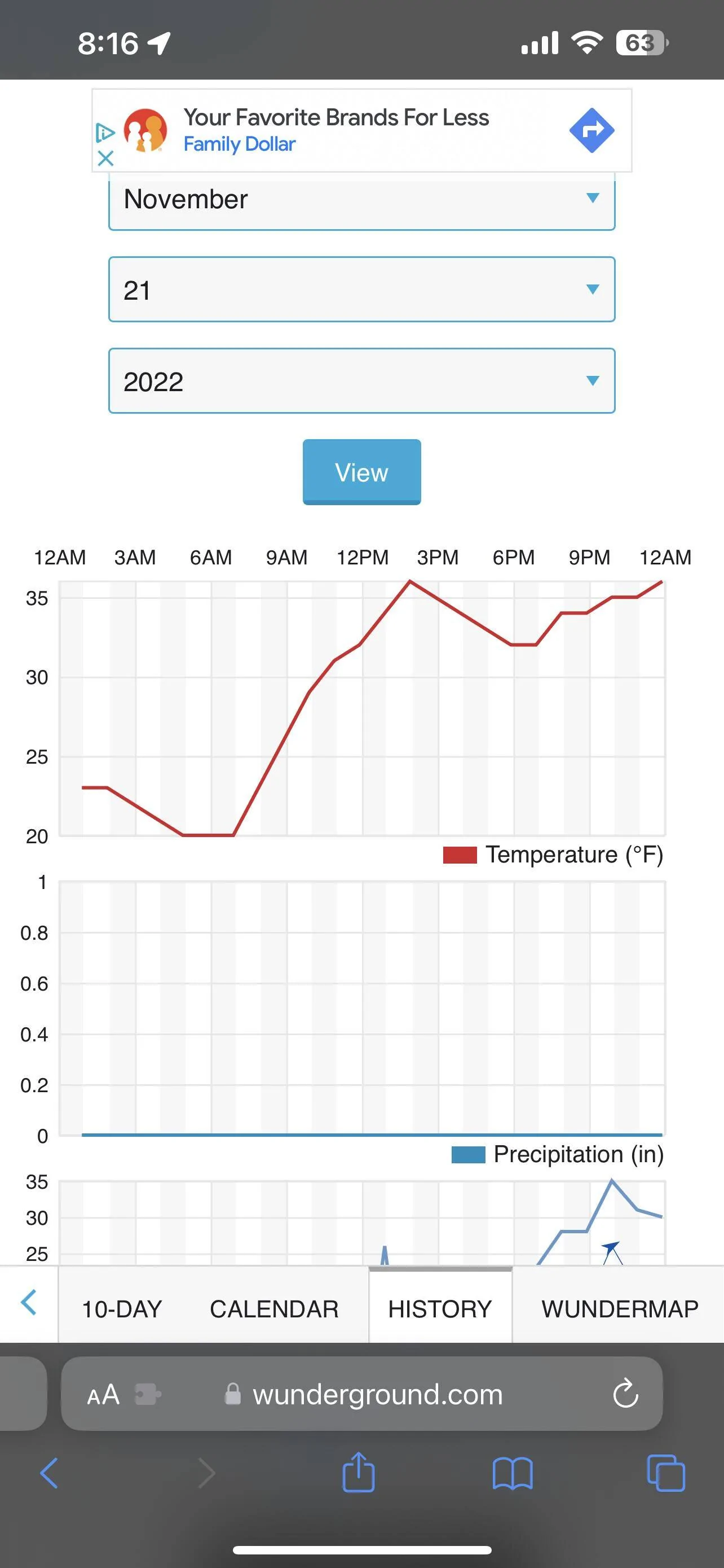

That’s absolutely incredible. In 30s I never average more than 2 miles per kWh and it’s usually closer to 1.7 miles per kWh. And that’s driving relatively conservatively. I don’t precondition at all though - do you? Heck, I can’t average 3.5 miles per kWh in perfect weather.
First thing working to my advantage is that my car is much less fun than yours! Some trips are much better than others. Here’s a recent example:
