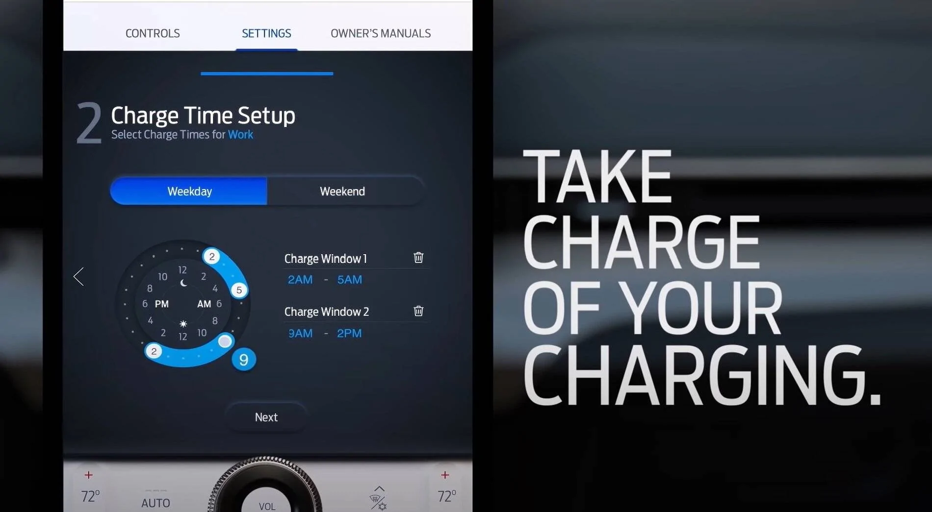

While we know the programmable charging on the MME can accommodate up to two start and end times each day, we don't know if you can program it to stop at a particular state of charge (SOC). I hope so but haven't seen that yet in any of the Sync4 screen captures or videos.
Hopefully it will, but that would be something new for Ford as the Focus Electric didn't allow you to set the battery % to stop at (granted with such a short range you always wanted 100% LOL).
Of course if this is any indication then you can't when you setup the times--of course it doesn't mean you can't it only means that you can't at this screen (if it is reflective of what the final software will look like). Maybe you can after pressing "Next".

That would be a weird omission. Hopefully it is possible.
Leaf has this same ability to set charging times but no SOC settings.
