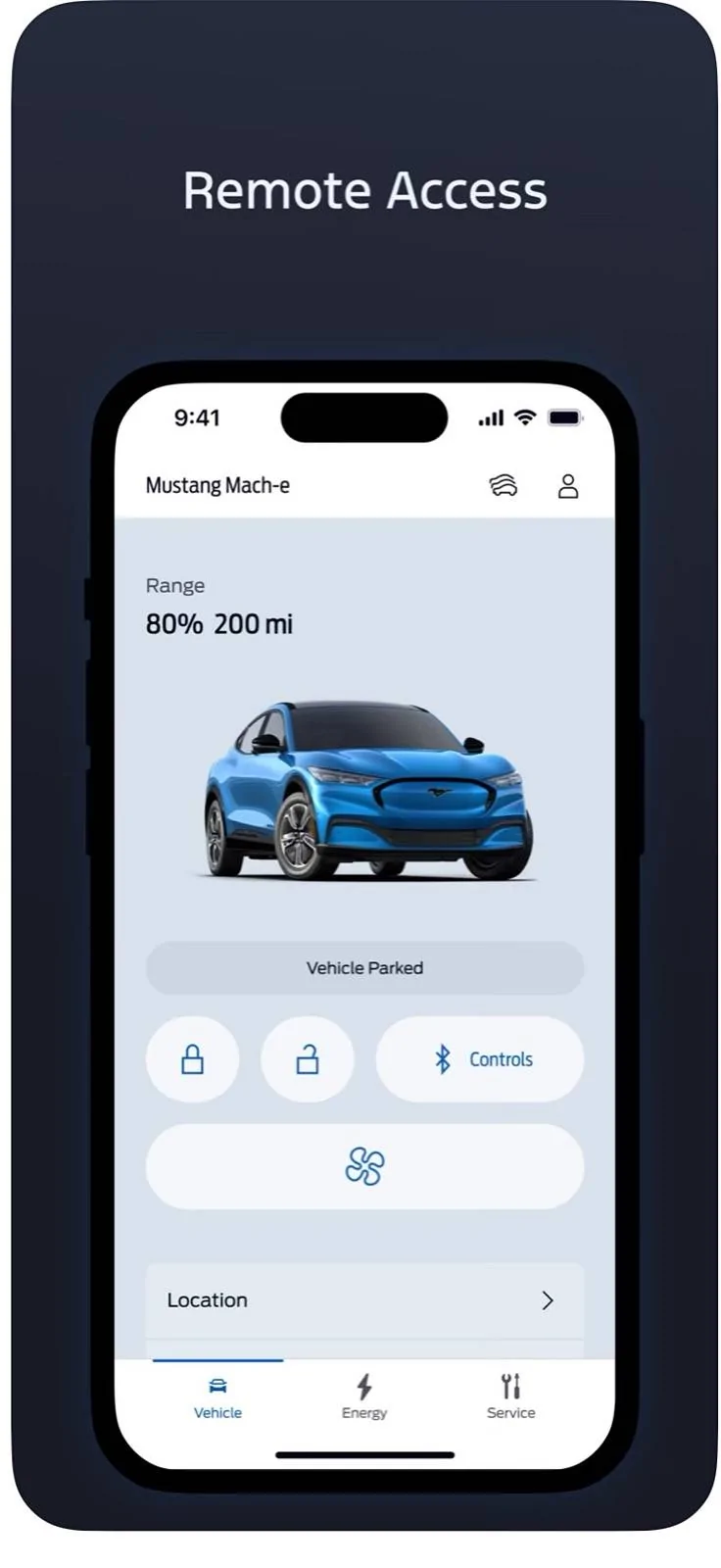

Just hung up with Ford Pass tech support. Advised they’ve purposely removed remote start from new app. Which incidentally simply appeared, no notice whatsoever!
As a long time Mache (my 2nd Mach) and disabled owner/driver, I travel with guide dog. This feature is must have for me!

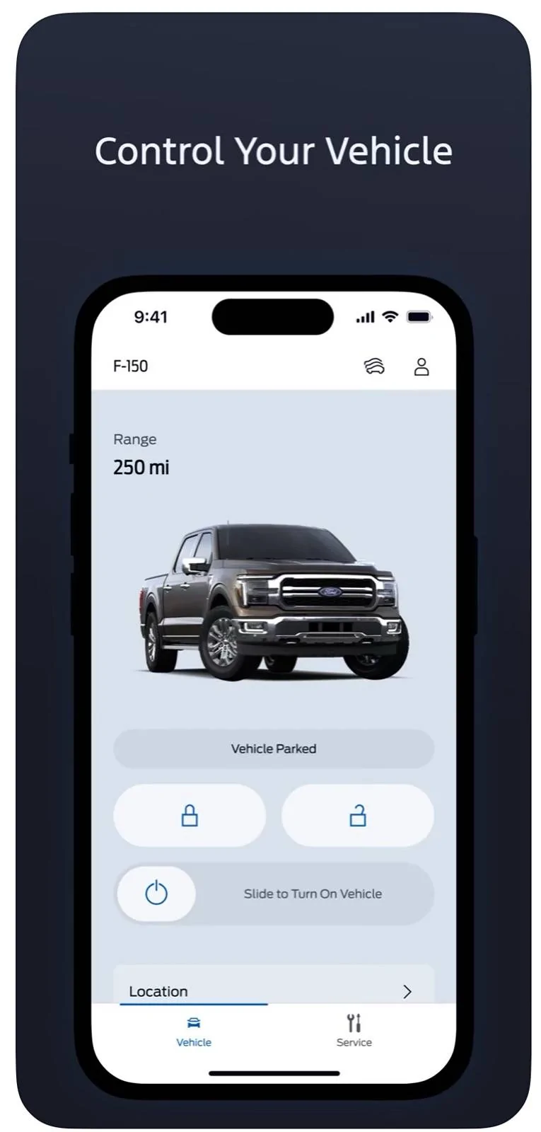

Ford Pass 1st told me to delete app and reinstall. Thankfully I was smart enough not to take that step! I told her I can see screen in app (attached below) no slide to start for Mach, only gas vehicle.
She then suggested using key FOB, except she then confirmed it isn’t feature on Mach FOB. Sadly she had no reason for removal or if it will return. She alluded to a safety feature? Doesn’t make any sense if available for gas powered vehicles, right?
Sooooo only option she gave is contacting dealer to have get a remote start key FOB, usually around $100. Can Mach’s even accept that antiquated technology?
I feel like I’ve entered twilight zone and went back to the 80’s/90’s when we had to have remote start & window tinting added outside dealers from car audio storefronts.
Thoughts? Anyone else know anything?

The climate control will NOT run indefinitely. The run time is based on what you setup in Sync. FordPass tells you the actual time it will turn off, as compared to the old version which displayed "Shutting off in X minutes".

I did see what you wrote but I never had to do that before. I will look at settings you’re mentioning. I was guessing app would give me indication if fan goes off. I’m going to test again. I did earlier and would have to agree with what you’re saying; my preset factory defaults must be 15mins. I was certain it went off and I didn’t turn it off.
Hopefully area you’re directing me to will tell me default time and allow me to adjust.
Now I understand your prior post more clearly! Many thanks!
