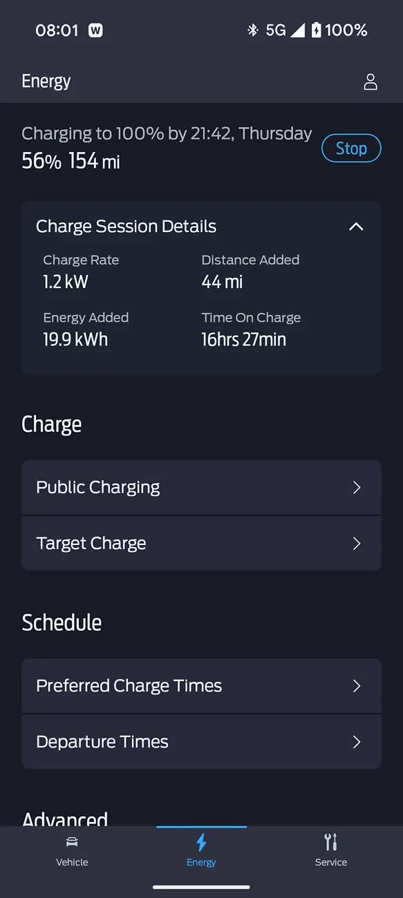

My Lightning is on an L1 right now.
Its predicted finish time is 21:42 Thursday. A more accurate estimate would be 07:47 Thursday.
The truck has a couple of preferred charge windows that are being ignored because there is no way the truck can get to my target charge level within a single charge window, even if its estimates were more accurate.
