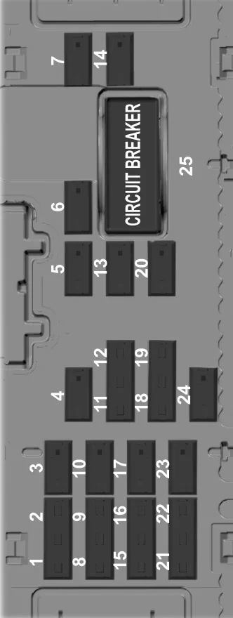

The fuse for the Drivers Door Module (DDM) which controls the mirrors, windows, door locks, etc. is fuse 14 (30 amp) next to the BCM in the passenger footwell. The thing is, not sure if it's the fuse as your panel was lit up and it also controls the lights in that panel. I think it would be best to have a dealer look at it.
This is what the view of fuses looks like in that area:
I'll give it a look-see and if it's a fuse it should be easy. I turned it off at an intersection, opened the door to 'force quit' and then turn it back on, but still no 'action'. And when I got to the office, I filmed this and tried off/door open/ on again with the same results.
