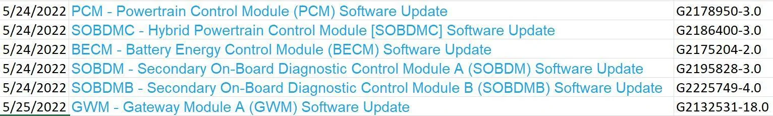

Today, I decided to see if I had any other updates available - other than the 22S41 Recall, which I don't want anyway. I have OTAs turned off and I haven't received any. The last update I performed to the car for the BECM and associated "recall modules" was in May with the software released before the recall. To my surprise I had no updates available, zero, zilch. I would have assumed that I had the recall at minimum, but nope. I confirmed this by checking my software versions against other GT/GTPE's that I know have the 22S41 recall applied. Confirmed that my version is 1 prior to the recall.
So, I took to the forums (here) and got a couple members to give me their VINs and with the help of VINs that @WyldStallyn had confirmed that 5 vehicles, all GTs and all from July of 2021 show the same old versions either installed or available with no recall versions available.
Could the recall have been pulled for everyone?
Through further investigation with multiple members running VINs, we are certain that is the case (read down a few posts on the main page). We can no longer find the recall versions of the software for ANY trims with ANY build dates. The only place we can find the recall software is on vehicles which previously had it applied before it was pulled.

I've received a couple messages from people who say they have updated with the recall software. While I don't disbelieve them at all, the interesting part to all this is that the updates for the "recall modules" had an update just 1 month prior. So unless you are carefully looking at the exact software revision, you would assume that the recall is available because the modules that require updating are likely showing has having available updates. This, because the May release wasn't installed OTA and due to its proximity to the recall version. So could there be some cars with the recall updates available today? Sure, but there's none that I've seen yet and we have collectively run probably 20 VINs. All that being said - that is why I have this thread labeled as investigative still. If someone wants to provide me their VIN who is claiming they installed them I would be happy to look. So far, no one has stepped up and provided that proof.

Non-Recall, May, Tool-Tip Versions (thanks @WyldStallyn):
