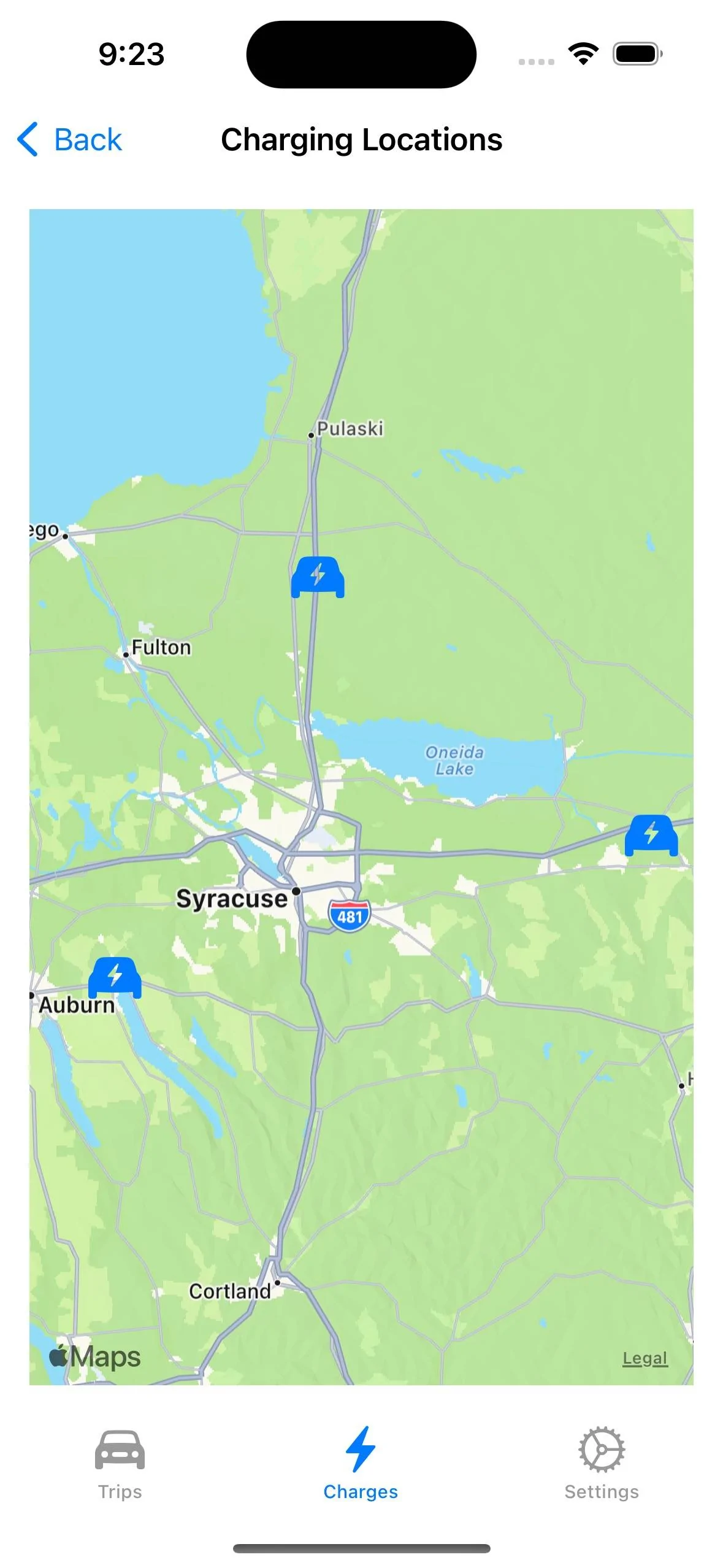

But DCFC charging will be coming otherwise my new map showing charging stations visited will be pretty sparse. This is a mock up with the two local Superchargers
Ford Mustang Mach-E OBD Play: an iPhone app for viewing Mach-E trips and charging data 1678419012096
