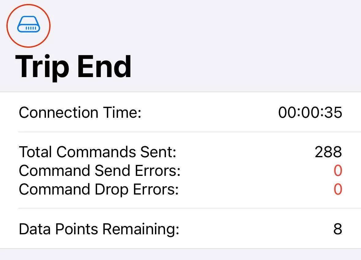

Since a few users were unsure that writes were taking place, build 0.50.6 now has a status bar symbol that shows if a trip or charge has been successfully written to your IinfluxDB data store (blue for a successful write, red otherwise).
