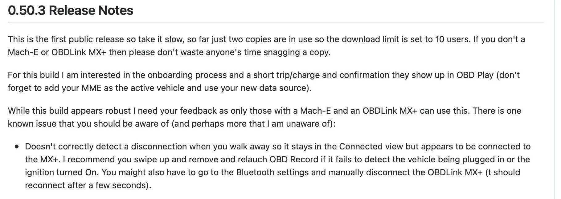

You don't need to delete anything but in the release notes it reminds you to change the active vehicle to your MME (using your VIN) and the active data source to your InfluxDB instance. If OBD Play is connected to your data source and is showing no trips then make sure your vehicle is being used to pull the data.
Also, if OBD Record cycled through the Trip Starting, Trip, Trip Ending state sequence the trip was probably recorded. You can log into your Influx DB account and use the Data Explorer to see if anything is there:
Yeah it did record. Thanks.
One thing people might appreciate is some kind of indication in the record app that a trip was saved and uploaded successfully? I don’t want to kill the app too soon if the data hasn’t uploaded yet.
Record app also still shows connected after I go inside 1000’ away from the car. iOS shows the OBDLink is disconnected in Bluetooth settings as well. Maybe you could change state to disconnected if you don’t get a response from the adapter after a half dozen attempts?
Congratulations, you need to be more trusting. Are you seeing it in OBD Play now?
You may have noticed the display is always on, I keep my phone next to gear selector so I can check it occasionally that it hasn't crashed. But if you end up in the Ignition On state after placing the vehicle in Park your trip should be recorded.
I knew of this quirk (it shows it is connected and that there are no comms errors) but wanted to get out, I fixed it earlier today.

Yes, I got everything working after deleting the sample data sources. Until then, I had no indication anything had actually recorded to the cloud, hence my confusion. Didn’t have time to figure out where to look in influx, that’s totally new to me and I’ll figure it out later. Just trying it out quick this morning.
