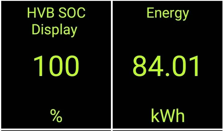

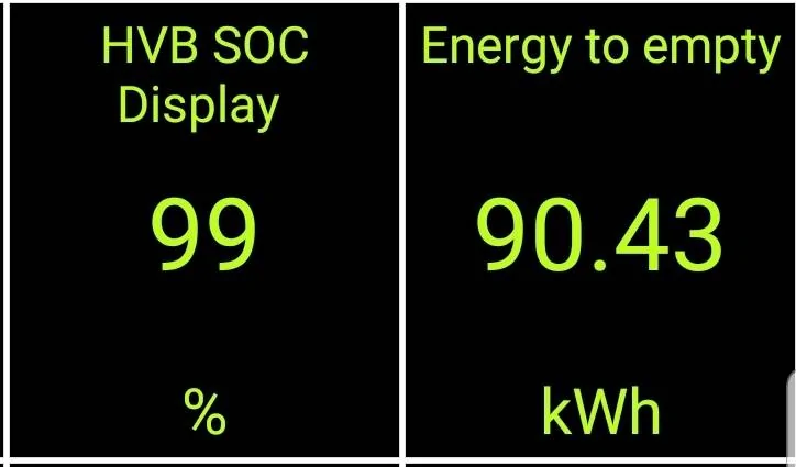

Not sure if you noticed, but if you charge to 100% you will not really see more than about 80 kWh EtE (even when the pack is warm).
Last Spring I was able to measure over 90 kWh EtE, but that was when the battery SoH was close to 100%.
Ford Mustang Mach-E OBD Play: an iPhone app for viewing Mach-E trips and charging data Screenshot_20230315-105113_Gallery
Now that the battery SoH is 92%, I get around 84 kWh EtE. Maybe your battery SoH is lower than mine?

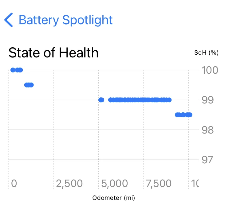

SoC displayed has integer resolution and is the value you see in the instrument panel, there is another SoC PID that has 0.5 resolLutron. I suppose that 99% could be 99.5% or 98.5% depending on how afore rounds it.
I can make a shameless plug on tracking your SoH:
Ford Mustang Mach-E OBD Play: an iPhone app for viewing Mach-E trips and charging data 1678895313603
