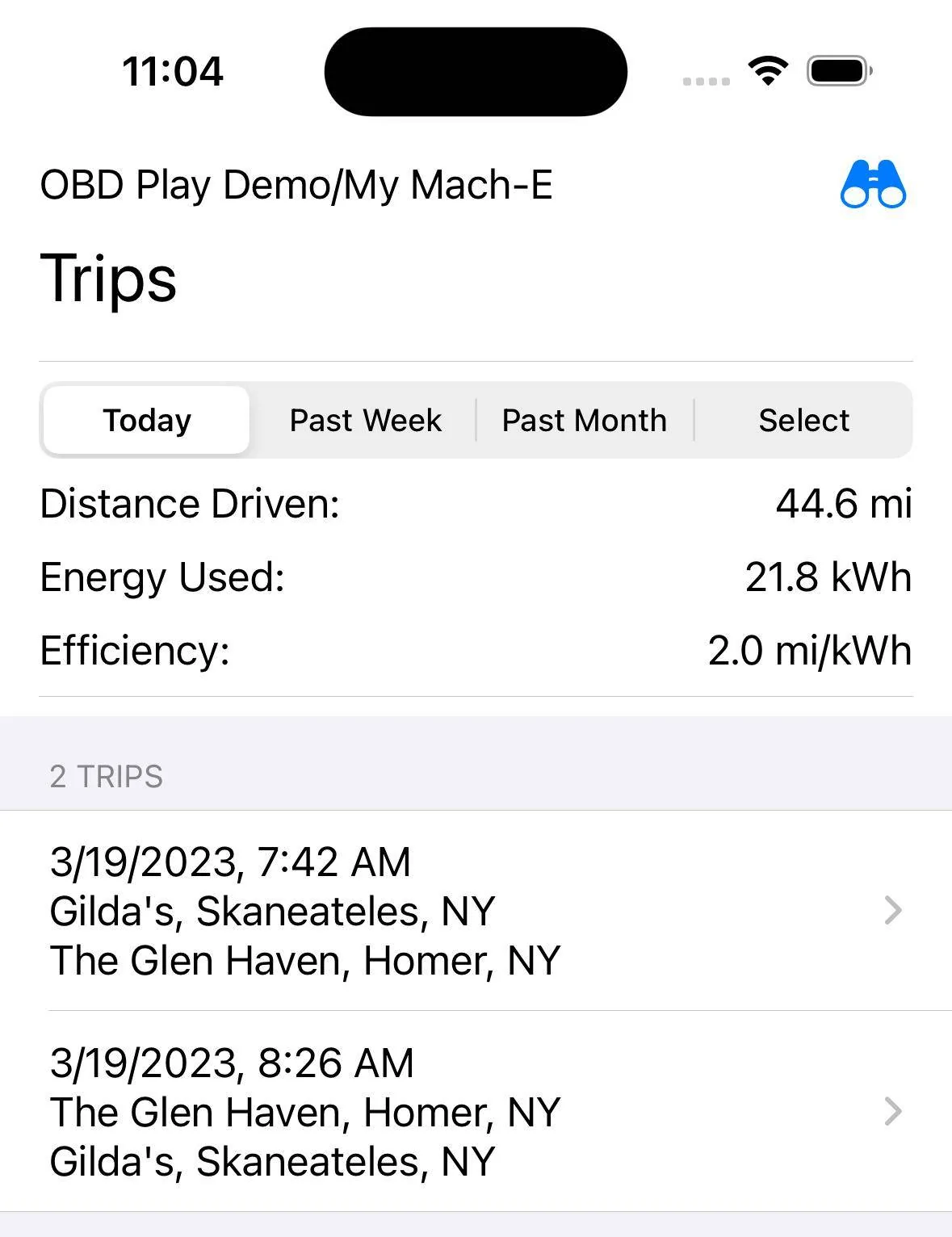

Happy Sunday! I just posted two fun trips in the OBD Play data source for your analysis and viewing pleasure.
Woke up to low 20℉ temperatures and blowing snow that should really be a drag on efficiency so how about a road trip around the finest of the NY Finger Lakes. These conditions are perhaps the last chance to grab a drive around Skaneateles Lake running on a mix of snow-packed and slushy roads and do some climbs and descents as the start and end points are all at (nominally 862' MSL) lake level but the south end has some nice higher elevations to explore thanks to the last ice age. These very wintry-like conditions might be the last for a while since the forecast finally shows spring-like conditions arriving later this week.
Ford Mustang Mach-E OBD Play: an iPhone app for viewing Mach-E trips and charging data 1679237082673
So how did we do overall?

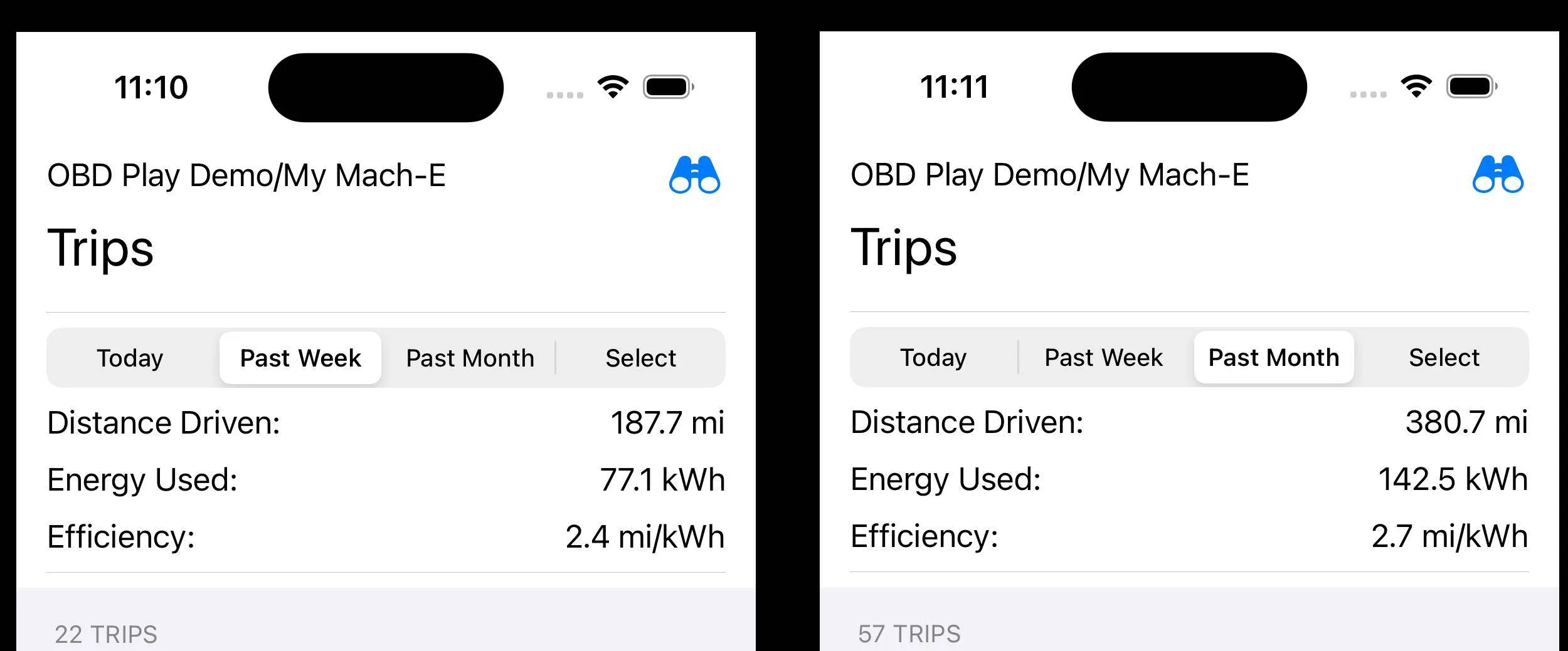

Ford Mustang Mach-E OBD Play: an iPhone app for viewing Mach-E trips and charging data 1679238346119
Yikes, that is way below the results from the past week and month.

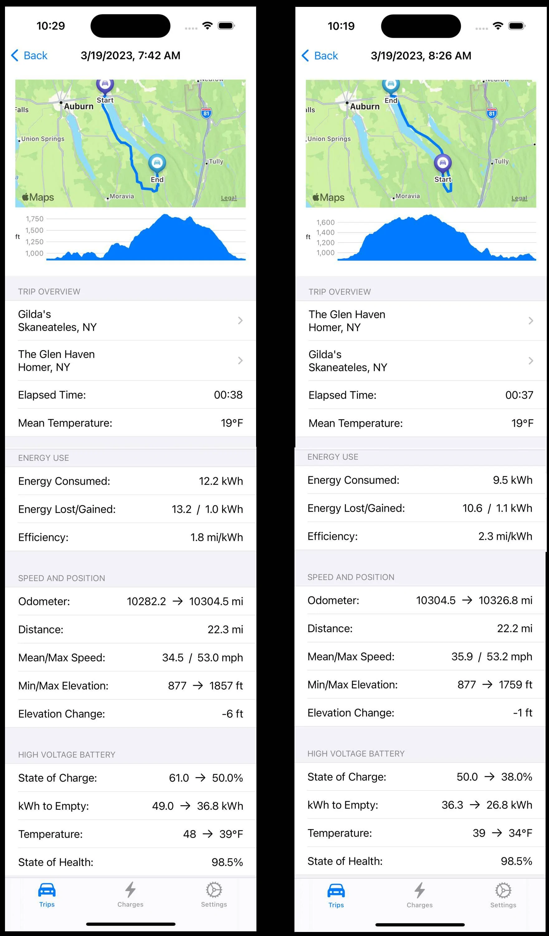

Ford Mustang Mach-E OBD Play: an iPhone app for viewing Mach-E trips and charging data 1679238752590
Let's dig in by looking at the two trip profiles, the left side is the downwind leg from the village of Skaneateles to The Glen Haven (a seasonal float-in dining spot at the south end of the lake) via West Lake Road and Bear Swamp with lots of blowing/drifting snow across the road. The right side is the return trip back to the village using the scenic East Lake Road via the hamlet of Scott in very similar conditions.
Ford Mustang Mach-E OBD Play: an iPhone app for viewing Mach-E trips and charging data 1679236291490
As expected the two trips took a bit more energy from the higher rolling resistance of the snow covered roads and cross winds in the less sheltered higher elevations, also note the HVB cooled down the entire way after starting from my (relatively) warm garage, something I don't yet collect data but on my to-do list. I am only showing the mean temperature for the trips but the range was 16℉ in the higher elevations to 22℉ in the village of Skaneateles.
