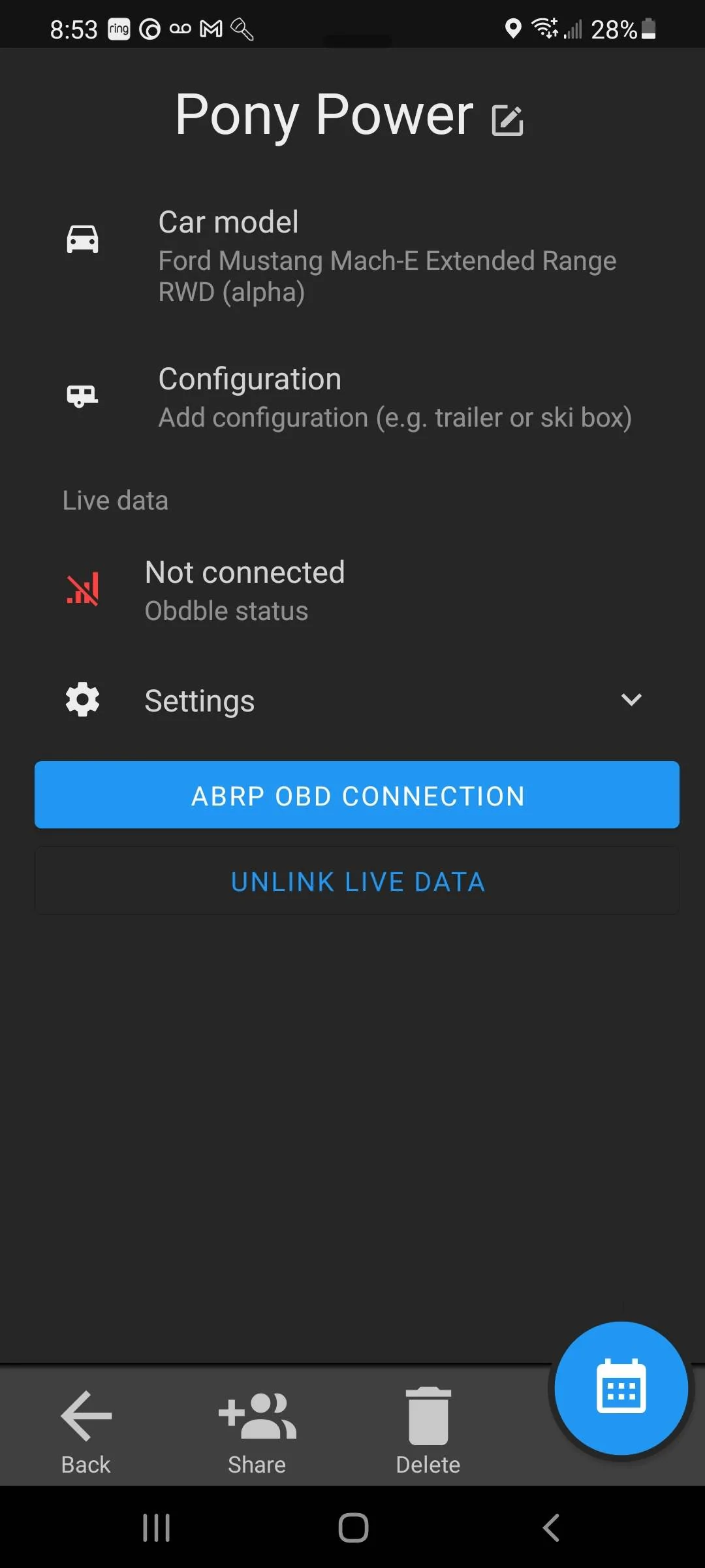

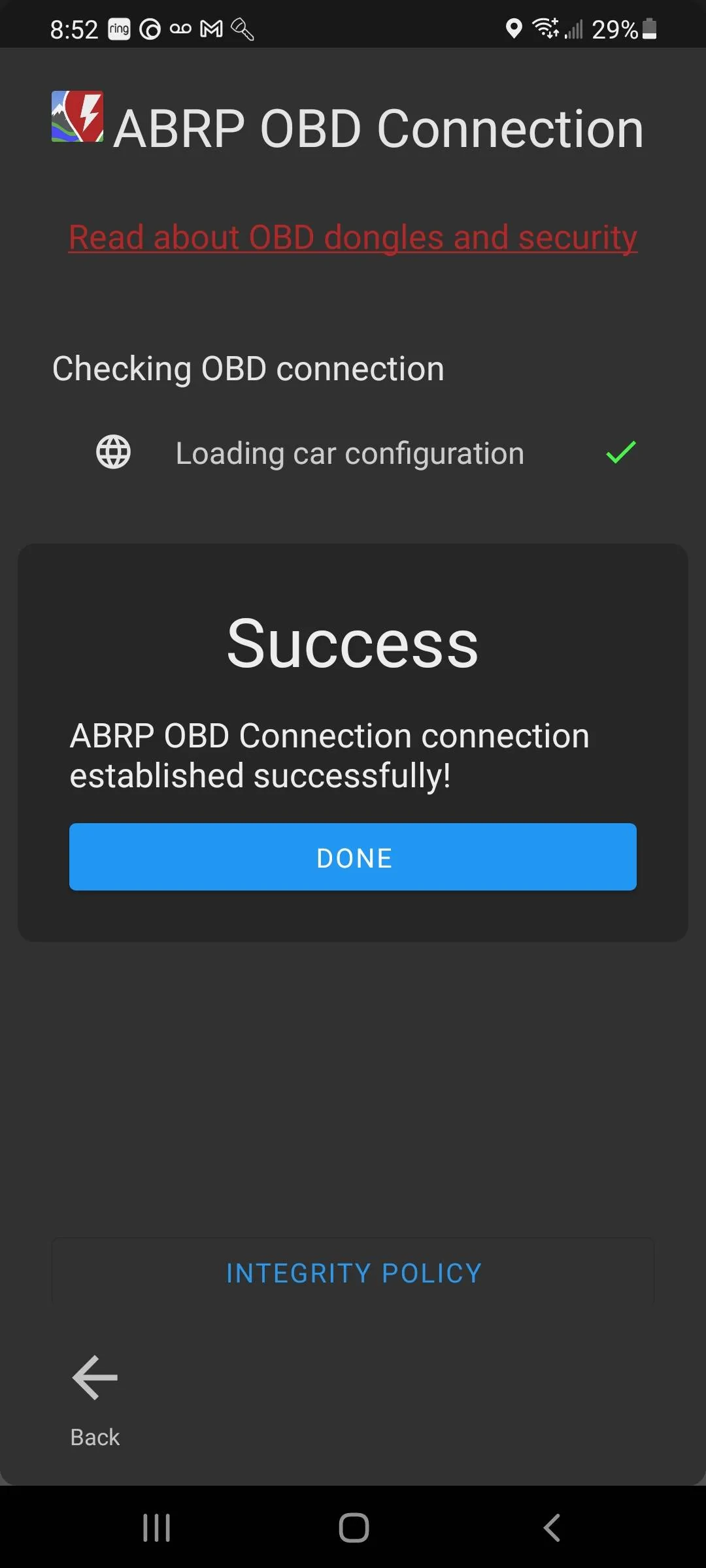

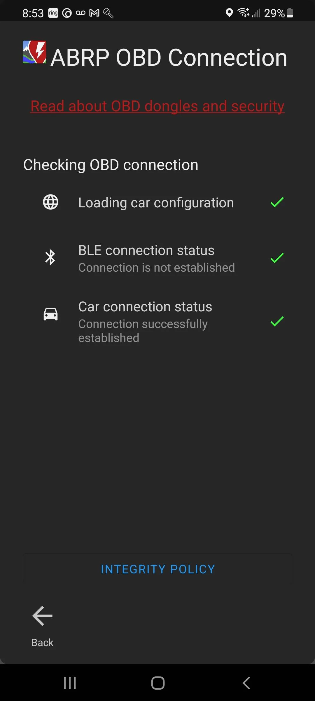

Ok, so I followed the instructions. got some live data. All was well for about 5 mins.

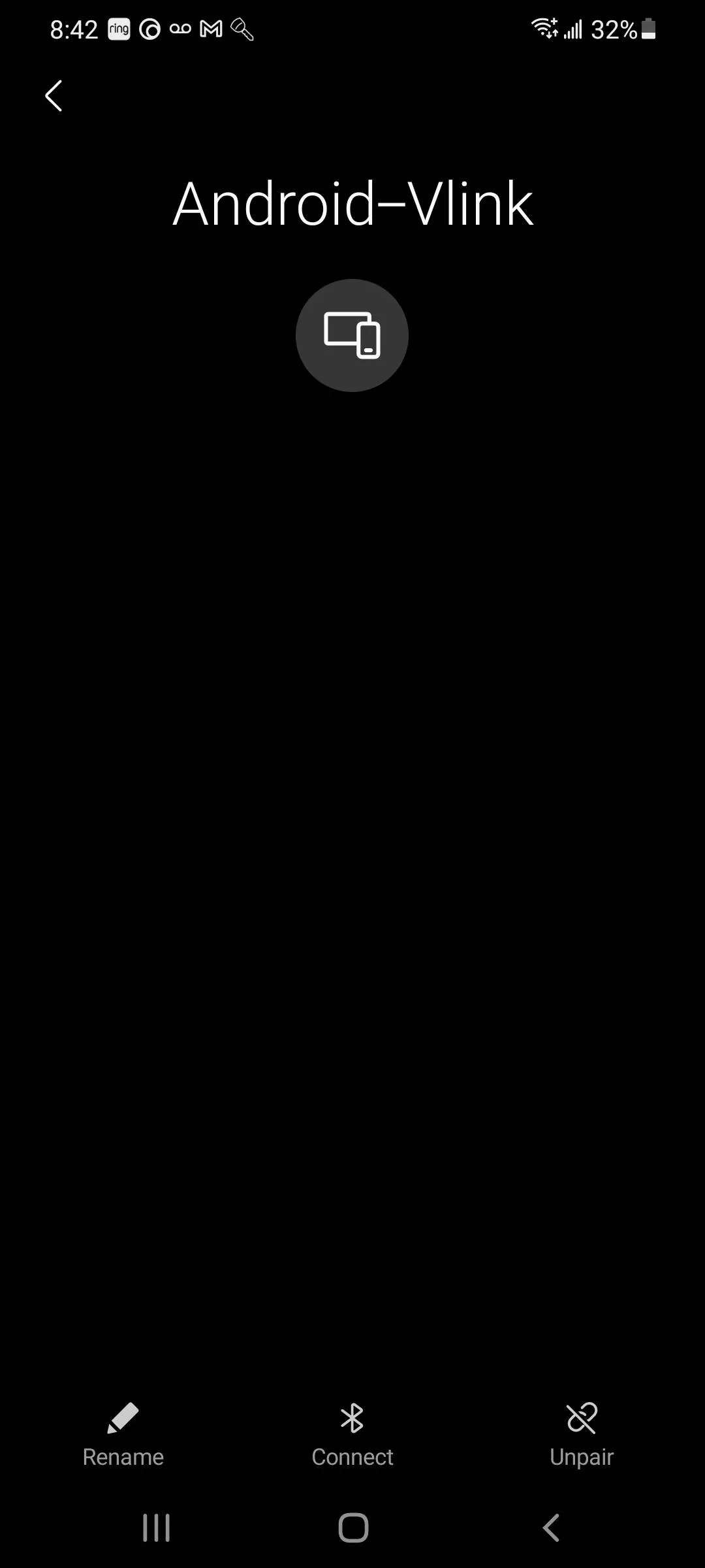

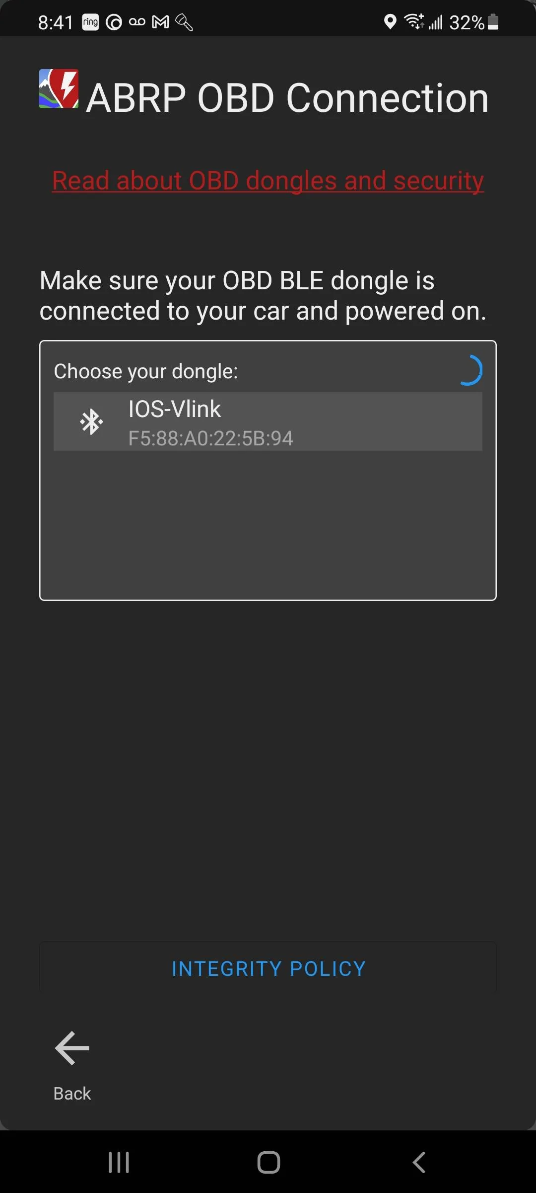

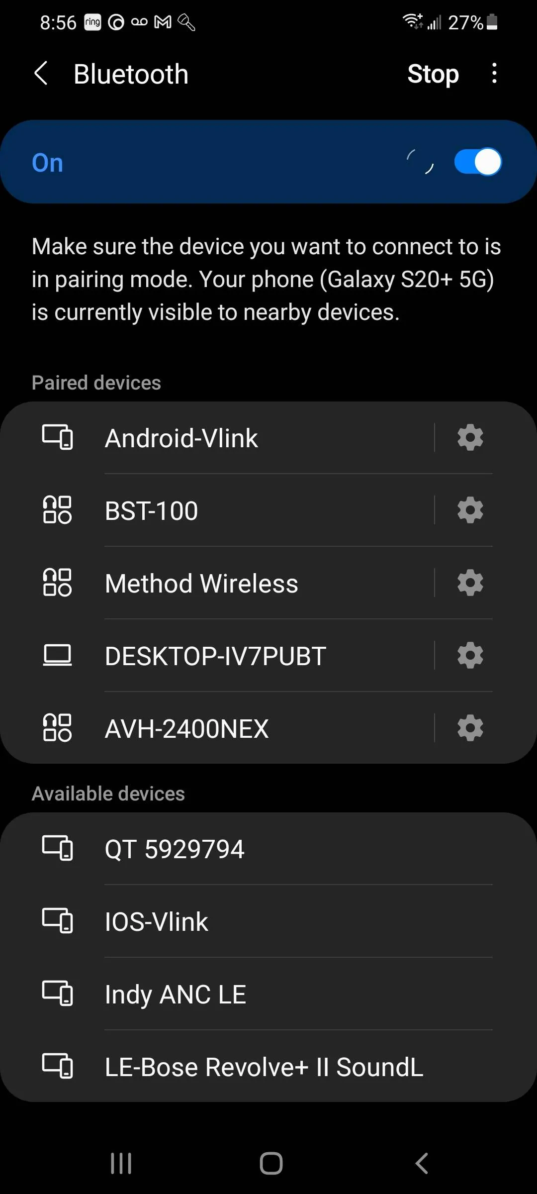

Some weird things though. When connecting in the app, Android VLink never showed up, only the IOS VLink. I have an Andriod device. In the BT connection screen, it shows Android as the connected device and the IOS at the bottom not connected. See attached pics.
After the success screen, when I go back the live data does not show up. It only showed up on the initial attempt. None of the subsequent attempts were successful.
Of course, I tried stopping and starting the App, turning BT off and On. Unplugging and replugging Dongle.
Any thoughts on how to fix this would be great.
Also, is this supposed to auto-connect if I walk away and come back? It would seem so.
I also updated the Dongle Firmware to the highest number. Maybe I need to roll back?
TIA for any help.

Looks like you're using PaaK. That completely breaks this for me. If I force close the fordpass app, it works fine.

I will force stop PAAK and try again. You can see i removed the MME all together from the BT phone and turned it off inside the car too.

You don't have to remove it. It just seems to be an issue when the FordPass is active and listening for the car on bluetooth. That seems to keep ABRP from being able to connect to the dongle.

Forced stopped PAAK and all is well.
