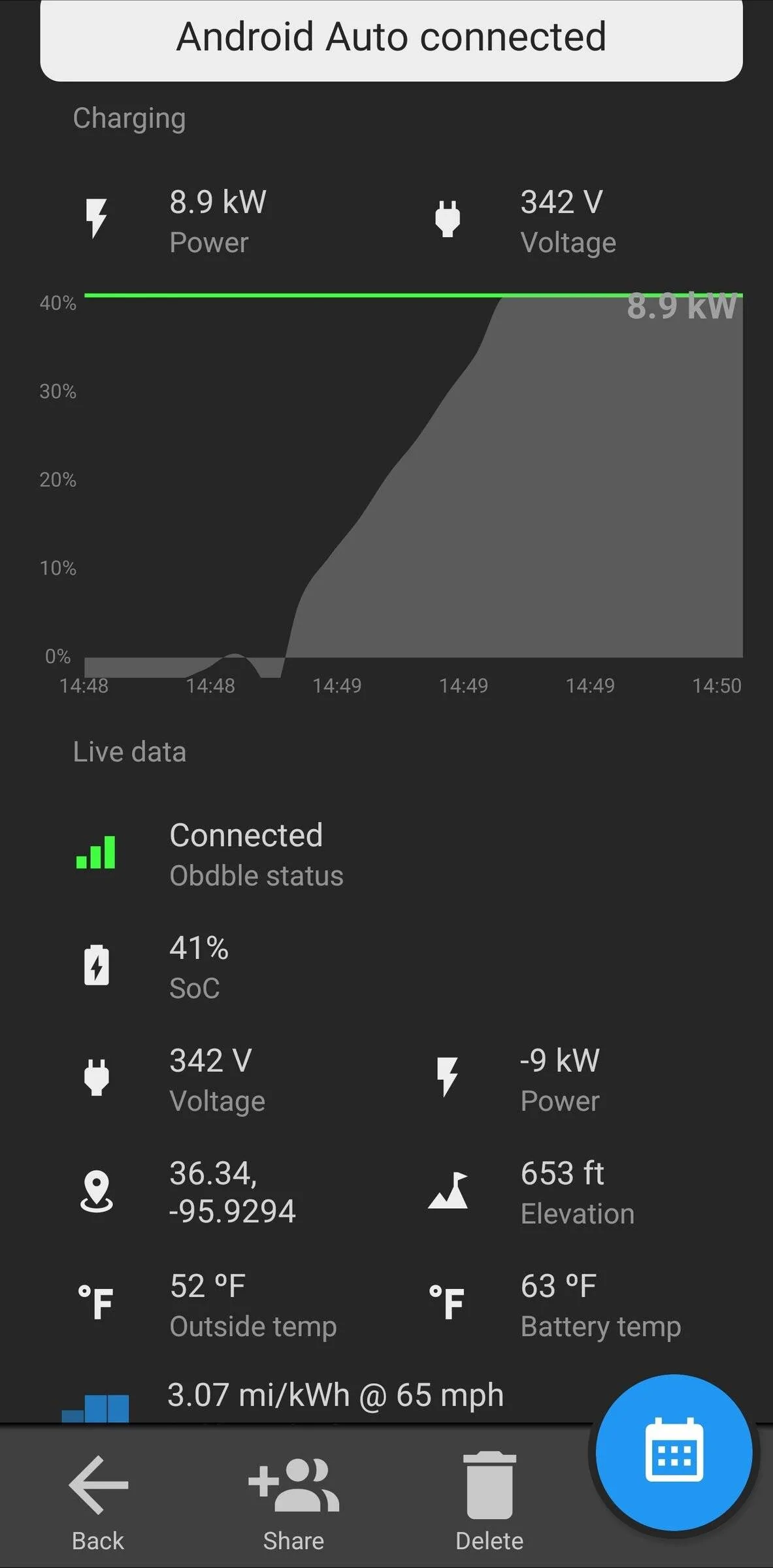

I got my VeePeak today and it works with ABRP on my Samsung Note 9.
I can see the data from the reader, and it shows the expected SOC at destination on the screen when navigating. I wish it would show more, sort of like what Car Scanner shows.
BTW, the VeePeak does not work with Car Scanner, at least on my phone anyway. I have an older non-BLE OBDII reader that works great with Car Scanner.
It should show you all the data on the car screen on the phone. It won't show this data on Android Auto or Carplay if that's what you're looking for.
