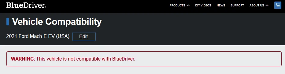

I read earlier that the Blue Driver Pro Scan doesn’t work. It has BLE
I couldn't get BlueDriver to work. As Ben mentioned, it only scans for some dongles presumably based on the BT MAC. Additionally, the MME isn't supported by the official BlueDriver app either. It will read some values but it's not a supported vehicle in their list.

I couldn't get BlueDriver to work. Additionally, the MME isn't supported by the official BlueDriver app either. It will read some values but it's not a supported vehicle in their list.
Thanks. I will return and get one of the suggested.

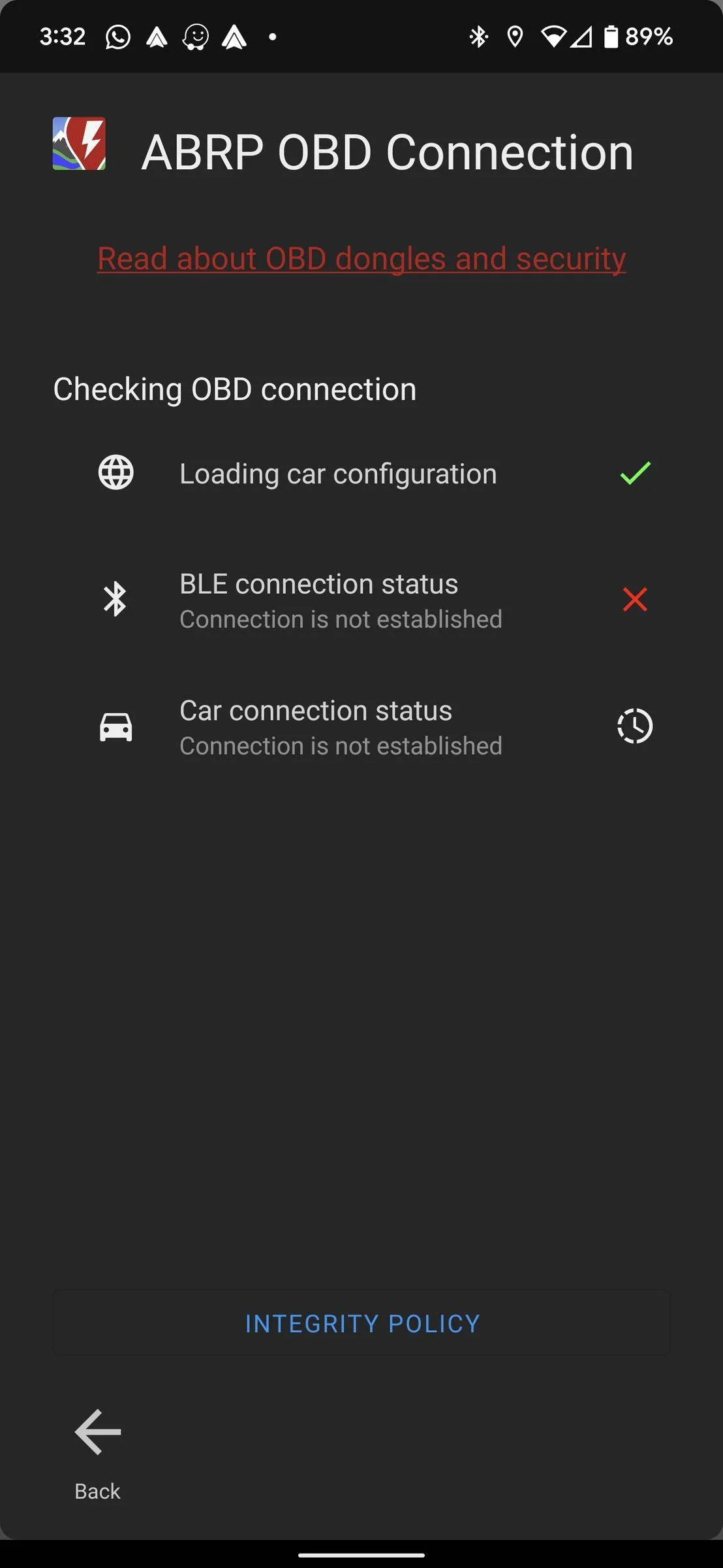

I did see instructions on the BlueDriver website on how to pair with Bluetooth LE (iOS).
For anyone who has issues getting ABRP to recognize the dongle you might have to pair it first. At least in my version of the app (Android) it would appear that the the app isn't calling bluetoothDevice.createBond(). Any supported BLE dongle should work so long as it's previously paired to the phone. Unless they are specifically calling LEScan then regular BT devices may work as well. Once the phone and the device have a bond the ABRP app can then take advantage of that. So for anyone who is struggling with the connection portion, pair the dongle first using the BT pairing on the phone.
