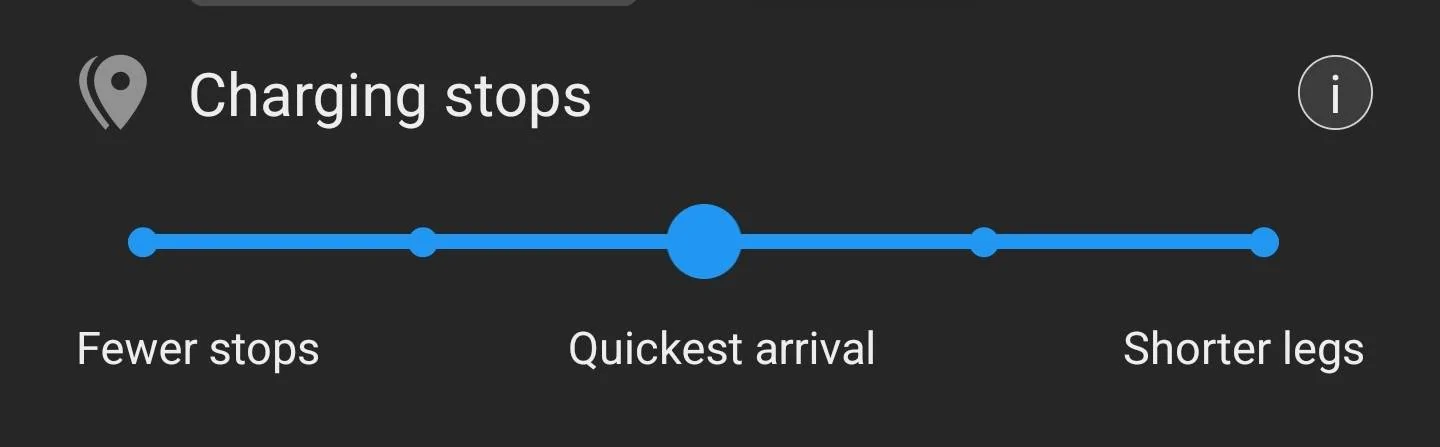

There is also the slider that gives you the option to customize how often you go to a charger. This actually does alter the route quite a bit. The farther left on the slider, the more likely it will keep you off of roads that would offer less efficiency.
Ford Mustang Mach-E New ABRP Feature : Live Data via OBD Screenshot_20211229-203845_Plasma Ember

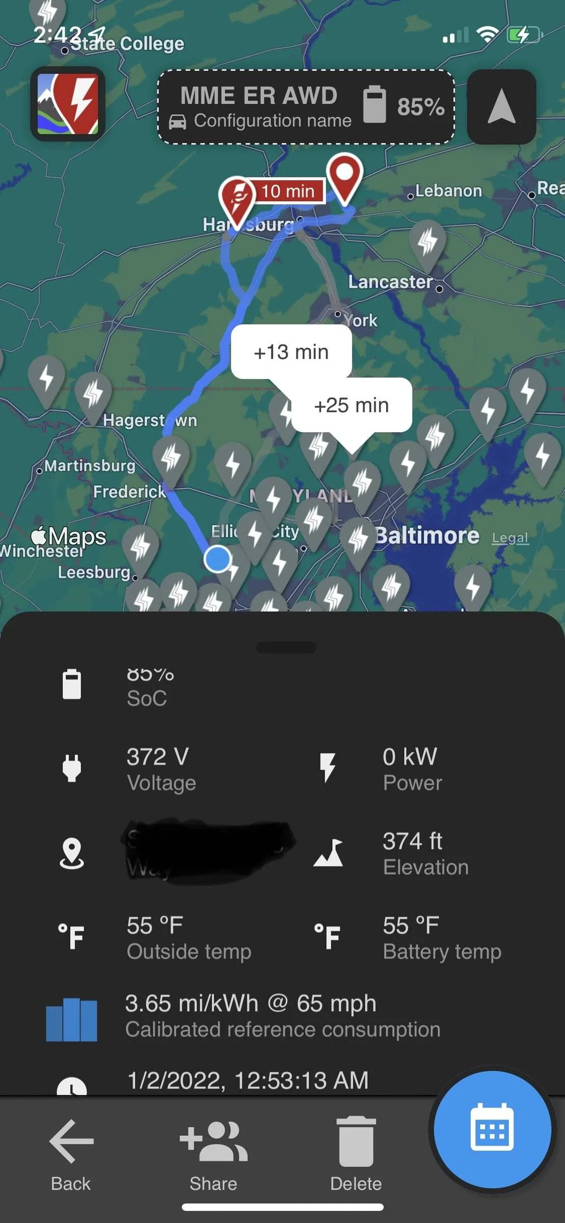

I‘ve had the live data hooked up for a few trips now. In the DC area we’ve actually had some warm (60°) days so that is a factor, but ABRP is giving this MME a calibration of 3.65 m/kWh based on my driving. Anyone else want to share?
Ford Mustang Mach-E New ABRP Feature : Live Data via OBD 1641155014926

This is what I have since enabling it.
This is on my GT. And lots of 80mph driving.
Ford Mustang Mach-E New ABRP Feature : Live Data via OBD Screenshot_20220102-142705_Plasma Ember

My current reference consumption is 3.29 mi/kWh with about a ~70% confidence level at various speeds. I have probably only driven 200 miles since using the ODB connection, most of which in 20F to 40F conditions, usually heavily loaded, some with a rear bike rack on.
