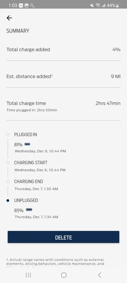

My wife came home at the usual time yesterday, 3:30pm, at the usual battery capacity (~80% remaining after daily commute) and plugged the car into the L1 charger. More than seven hours later, according to the charge log, the battery capacity had only increased 2%, but the energy had been flowing the entire time. This also agrees with our Enphase Enlighten energy consumption monitor which shows that we were consuming the expected amount of electrical energy that entire time, assuming the car had been charging.
Around 11pm I noticed the issue. Unplugged the charger, plugged it back in, and then a few hours later it had reached the target 85% charge.
So, what in the world happened here?
Ford Mustang Mach-E Odd charging session. Screenshot_20231207_130240_FordPass_540
Ford Mustang Mach-E Odd charging session. Screenshot_20231207_130309_FordPass_540

I must be missing the point. In the first charge log, both the Enlighten energy monitor and the FordPass app say there have been 7 kWh energy delivered , but the battery charge only increases by 2%. In the second charge log, the battery capacity increases as expected.
One thing I haven't mentioned is that just prior to this, Power-Up 6.6.0 was installed. I've no idea whether that is relevant.

What I'm seeing is that after plugging in, the SoC typically declines as much as 5%. So I might arrive in the garage at 80% charge showing, and a few minutes after connecting it's showing 75% SoC. From there it goes on to charge at the expected linear rate.
