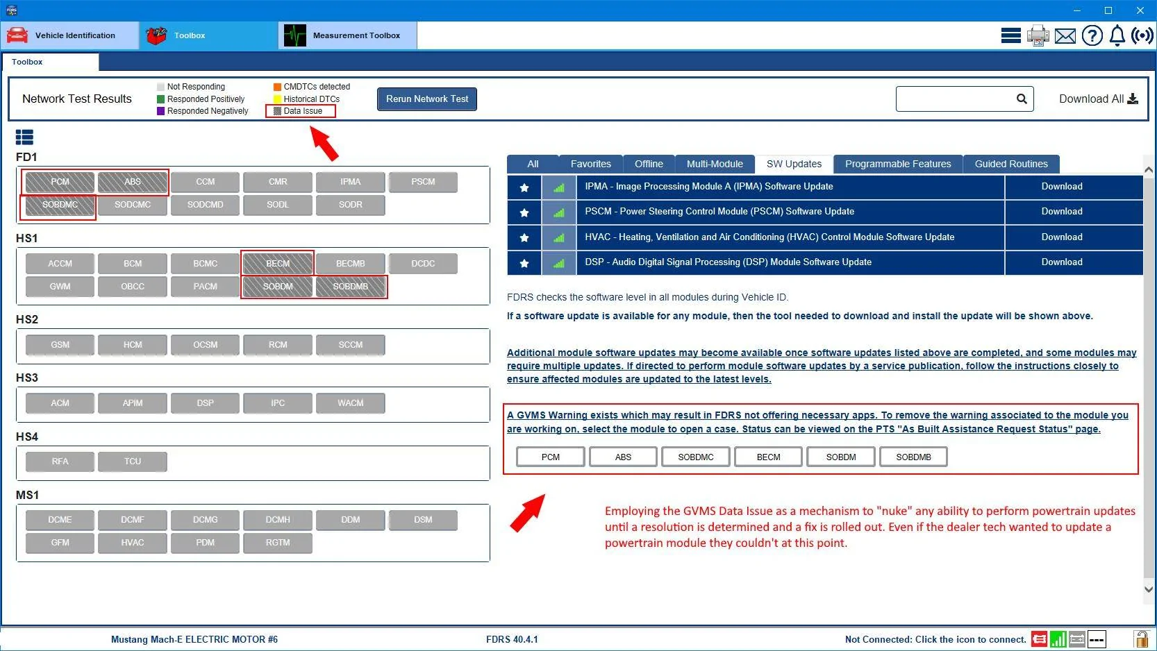

There are only going to be a handful of vehicles with this issue (<50) because they stopped it relatively quickly and it wasn’t a widespread release.
I'm pretty sure it's more than that. Look at the number of posts about it. And not every owner is a forum member here. So there are lots of others we don't know about. And from when I first updated and noticed the drive mode uncommanded switch thing, (I don't use 1PD) it was at least a week and half later that they left those updates as available to apply in FDRS. In fact the GVMS Nuke Option to prevent further powertrain updates by dealer techs was only deployed yesterday.
Ford Mustang Mach-E One Pedal Drive problem caused by recent updates Powertrain_Nuke_Option
