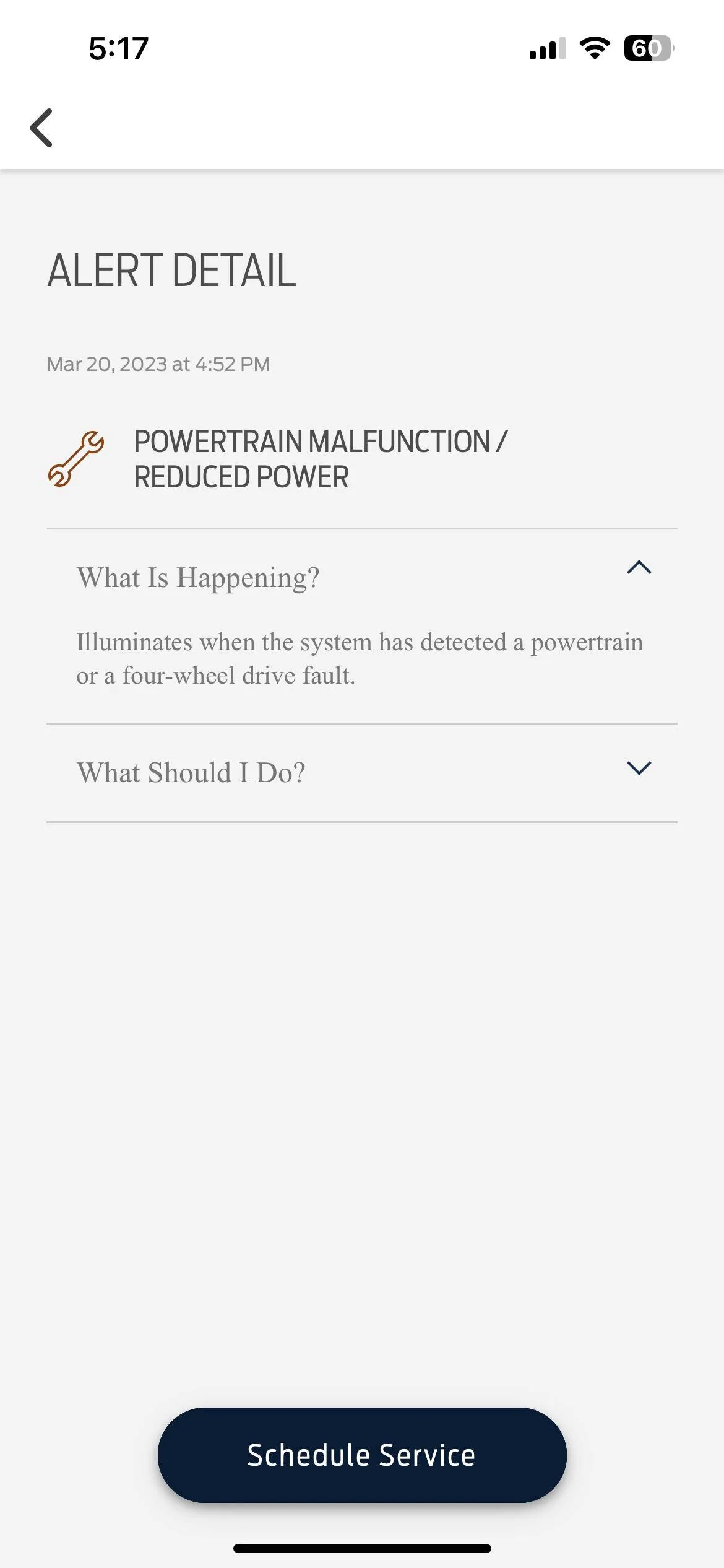

I just got this on my 2021 First Edition.
It also came with a “service soon” yellow wrench.
I restarted the car and the 1PD worked fine but the “service soon” message stayed.
now I have this in my Ford Pass
should I be worried?
Hi there, I'd be happy to look into your Mach-E concerns on my end. Will you send us a message with your VIN and dealership info? I can look into things on my end.

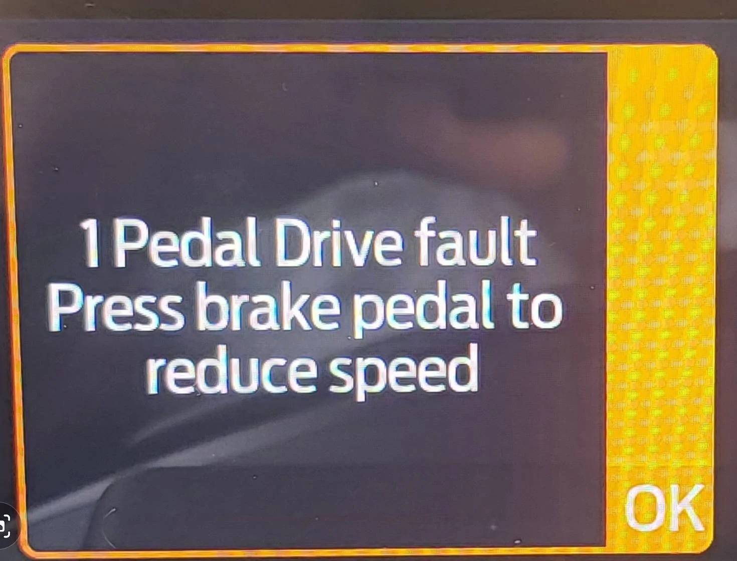

Just got an error message on the instrument screen: "1 Pedal Drive Fault Press brake pedal to reduce speed"
Restarted the car, the message went away.
The car is set to use 1 pedal driving. When the message was on the screen, the 1 pedal driving was clearly not working.
Anyone seen this?
The last time this happened to me, I was driving spiritedly and applying friction brakes to dry the rotors after a car wash. I got the brakes so hot that I got the one pedal fault message.
Once I got home, I could hold my hand outside of the wheel well and feel all of the waves of heat coming off. The ambient air temperature was 45°F.
Anyone seen this?
It's been happening to me on both 1-pedal drive and standard. I can duplicate the alert when I stop at a red light or parking lot Idling. It comes with a secondary visual alert on the main screen showing the front right bumper with a red light. I thought I took a picture but didn't. I will update my post with it soon.
I just got that same alert last night on my 22 premium er awd. How did you make out? I’m heading to the dealership this morning. Sorry, I know your post was back in march.
it was just a fluke for me. I just had gotten an OTA update and I guess that was it.
it didn’t happen again after
