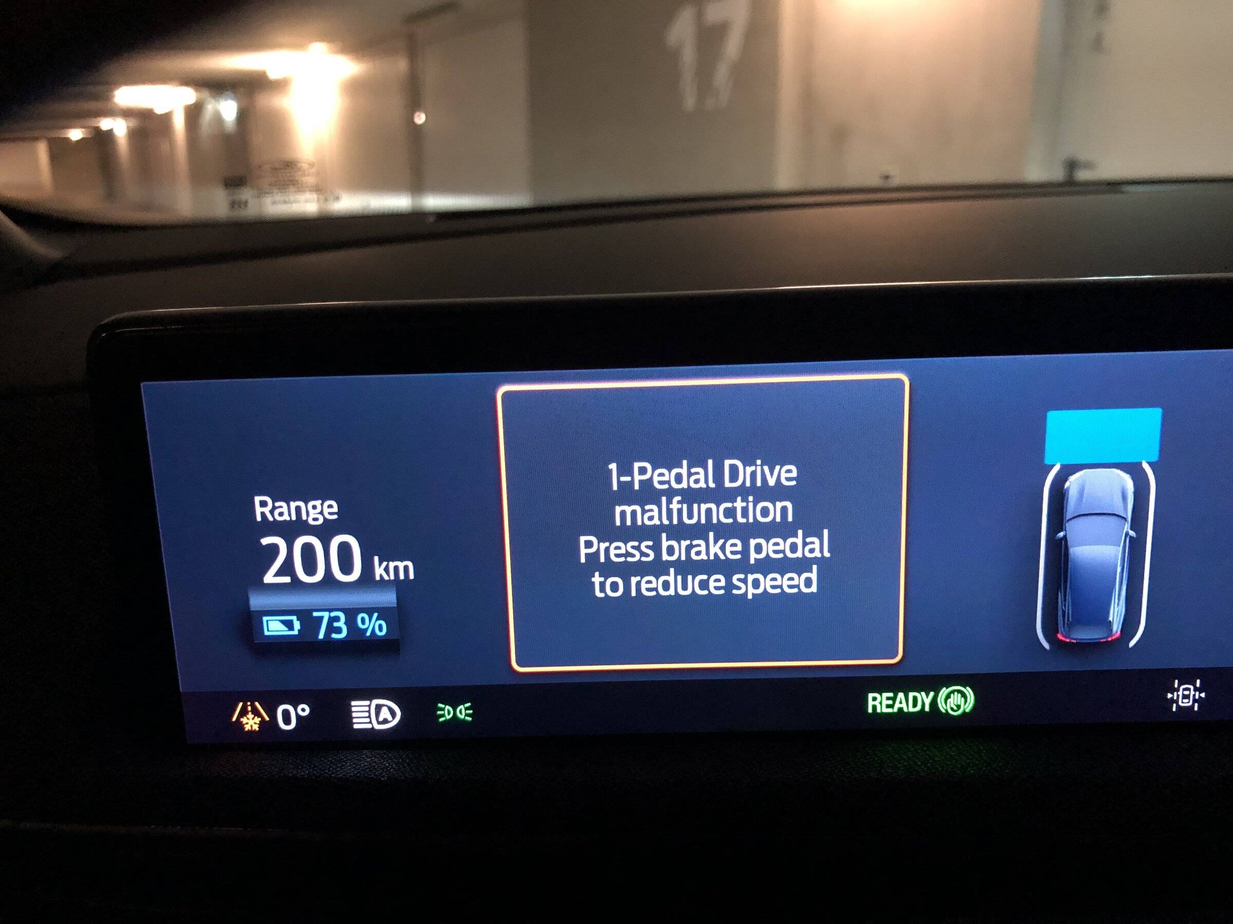

Got my car in August 2021. Seen the "1-Pedal Drive malfunction" once a few weeks back. Was quite scary since I was driving downhill into a garage and the car sped up quickly. Battery was at 73% and I had been driving around town for ~30 minutes. Malfunction went away after restarting the car.
Hello! Send us a private message with your MachE’s VIN and name & location of dealership. I’d be happy to see what I can do to assist with this brake pedal concern. Thank you!
