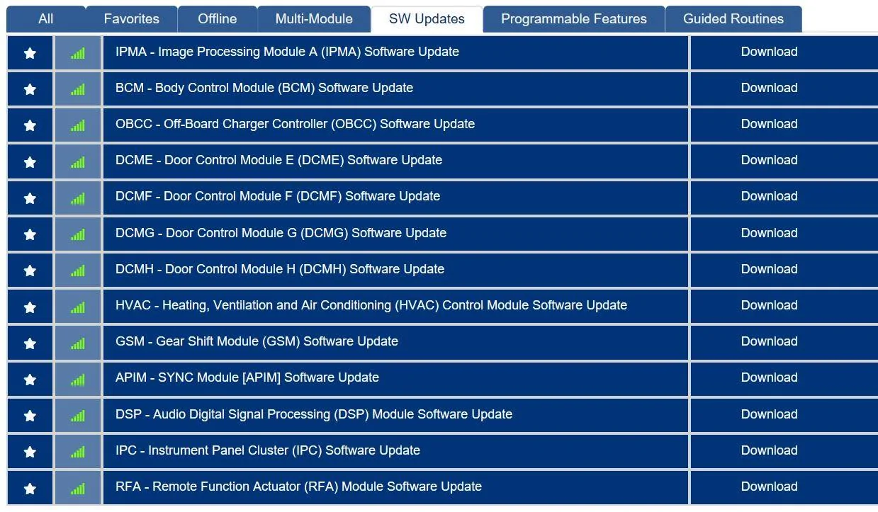

Looks like they're still working on it. They still have a ways to go.
Thank you! Just got an accidental unplug message from FordPass.
In fact they have a Looong way to go looking at the IPMA and IPC hanging out there. The APIM update(s) will all fall in line after those two are done. And the APIM will repeatedly have updates until Sync 364 is achieved. Also not shown is the GWM (gateway module) which will have updates pop up after other updates have been accomplished. Its a process of "whack-a-mole" until the system arrives at BC readiness with no remaining updates to the IPC, IPMA, APIM, GWM, Power steering and powertrain control modules. The other updates shown would be nice to have done at the same time but because the tech isn't really getting paid to do those you may end up with those still outstanding. All the doors take about 2 mins apiece and about 3-4 mins for the HVAC.
Thank you, Mike. They said they would need it through tomorrow. I asked for an update in the morning. At least, it is being done. Will see if they go all the way to then end now.
This was not just for BC, I am one of the ones that got stuck on the 1.7.1 OTA so they need to do that first. And they better do the doors, as I can not open the driver's side passenger door unless I open the driver's door first.

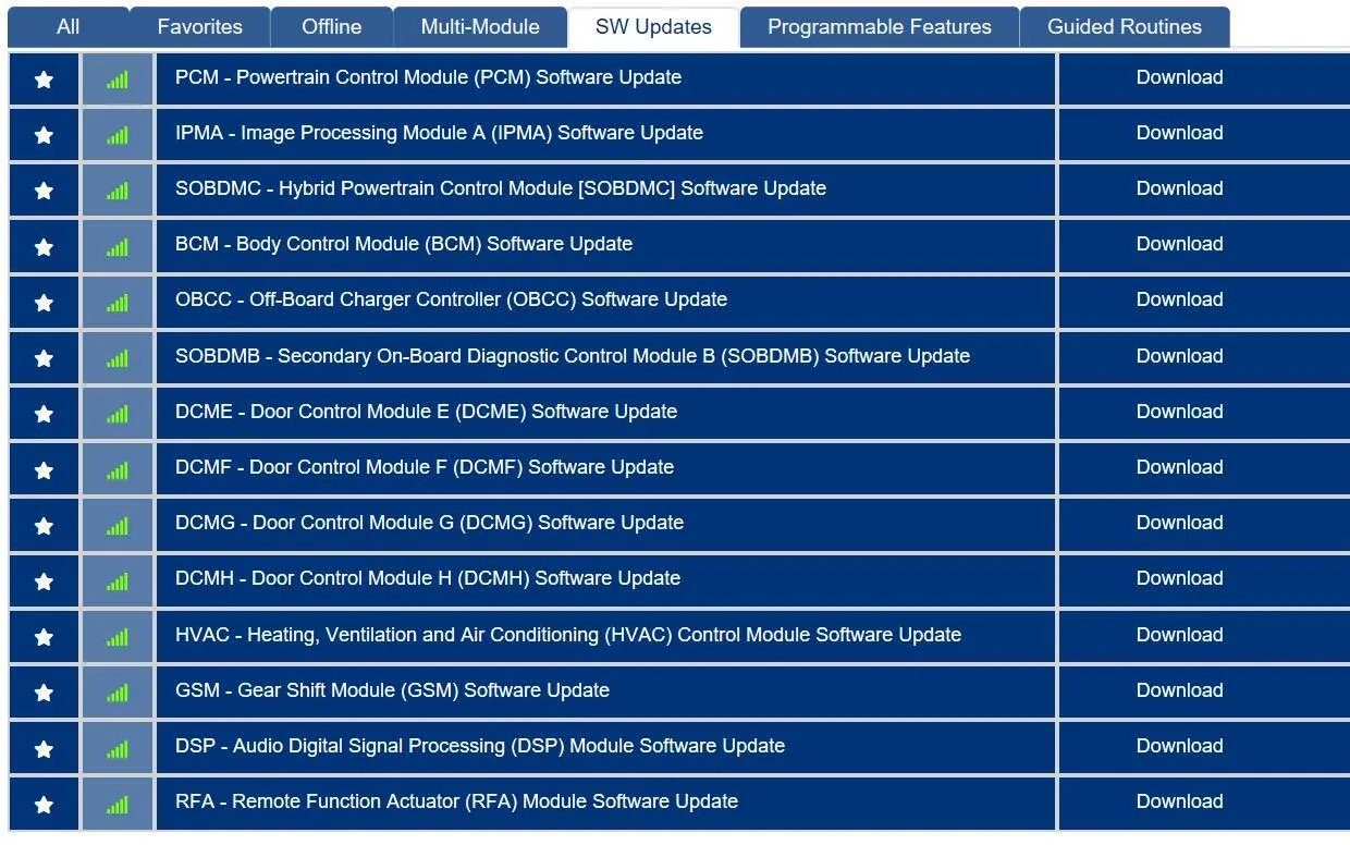

Heres my updates needed for my dealer to finish. thanks to generaltso, for those curious. Any ideas on how long it should take them?

The doors are included in 21P22, as are the OBCC, BCM, and RFA, so those should be done as well. With any luck, they'll just keep going down the list and do them all. But we know how that often goes.
What is the change to the doors? And how bad do I need it?

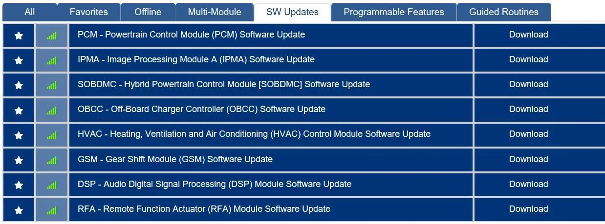

Would someone be able to run my VIN? It might be interesting (at least for @Ford Motor Company ) to see if all the dealers are applying the same (incorrect) subset of updates.
I can't imagine navigating this confusion without this forum. Thanks for everyone's help here!
This is what you've got available:
