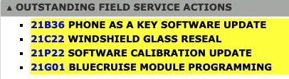

Even more annoying, Ford seems to have the FSAs correct for my vehicle
Ford Mustang Mach-E Optional Product Improvement Program 21G01 - BlueCruise Programming Screen Shot 2022-04-07 at 9.05.31 AM

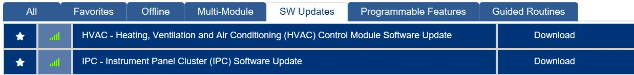

Is there anyway available who can run my VIN? I also just picked up for the update and still don’t have BlueCruise
Looks like your dealer ran a bunch of updates yesterday, but the IPC kept failing. BlueCruise isn't going to work until you can get that IPC updated successfully.

Looks like they're still working on it. They still have a ways to go.
Ford Mustang Mach-E Optional Product Improvement Program 21G01 - BlueCruise Programming 1649344972058
Mike G
Mar 27, 2022
6,469
5,327
N. AL, USA
In fact they have a Looong way to go looking at the IPMA and IPC hanging out there. The APIM update(s) will all fall in line after those two are done. And the APIM will repeatedly have updates until Sync 364 is achieved. Also not shown is the GWM (gateway module) which will have updates pop up after other updates have been accomplished. Its a process of "whack-a-mole" until the system arrives at BC readiness with no remaining updates to the IPC, IPMA, APIM, GWM, Power steering and powertrain control modules. The other updates shown would be nice to have done at the same time but because the tech isn't really getting paid to do those you may end up with those still outstanding. All the doors take about 2 mins apiece and about 3-4 mins for the HVAC.
The doors are included in 21P22, as are the OBCC, BCM, and RFA, so those should be done as well. With any luck, they'll just keep going down the list and do them all. But we know how that often goes.
