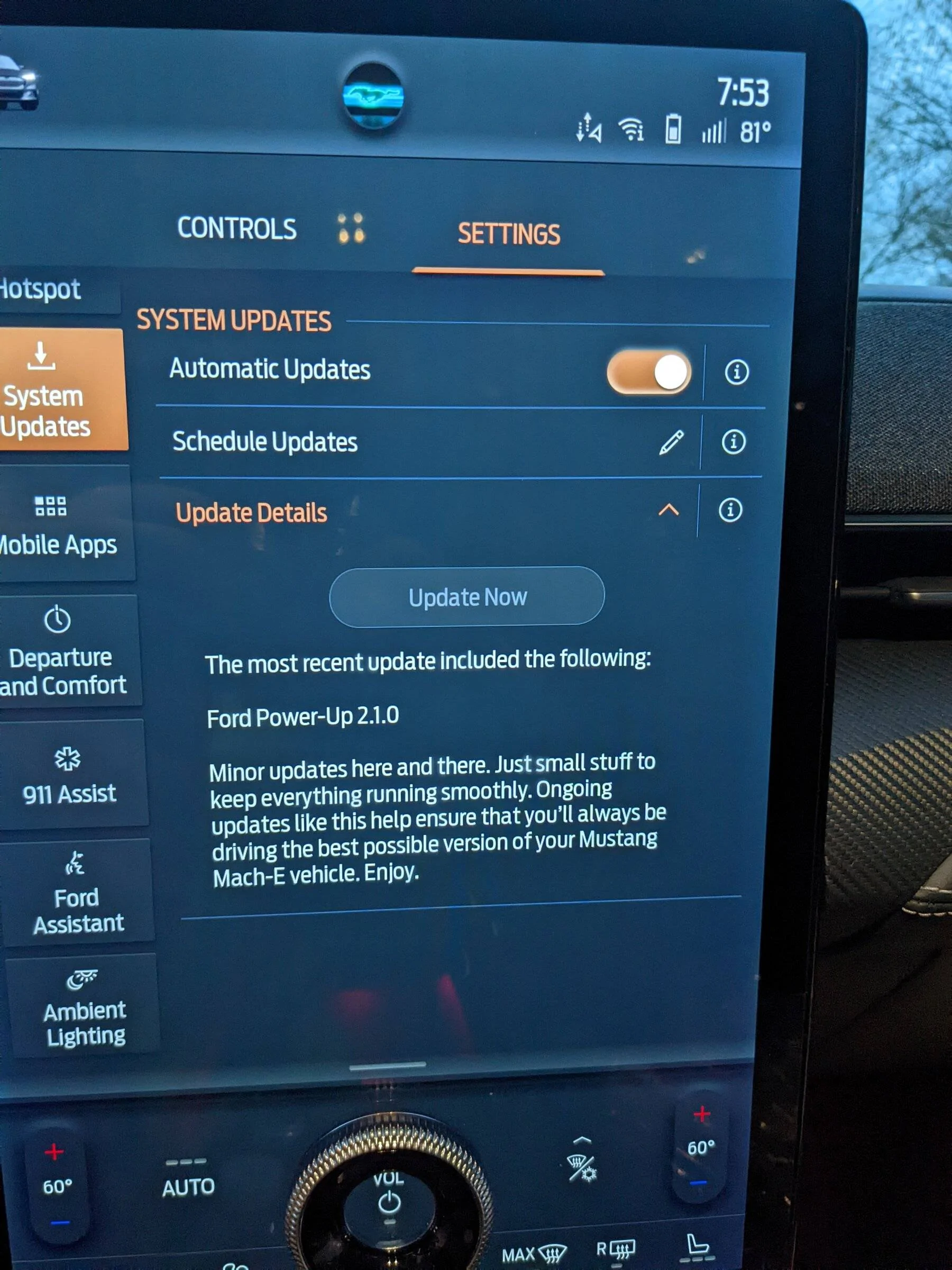

Hey so I just sent my car in today and just picked up my car. I didn't see any available option to turn on "hands-free". I drove back to work on a highway and didn't have BC.. I also didn't have copilot360 anymore. Did the dealer not do something? Or do I just need to wait a bit?
I'm also on 2.1 still.
Edit: when I turn lane centering off and then back on while driving a message pops up saying "BlueCruise not available"

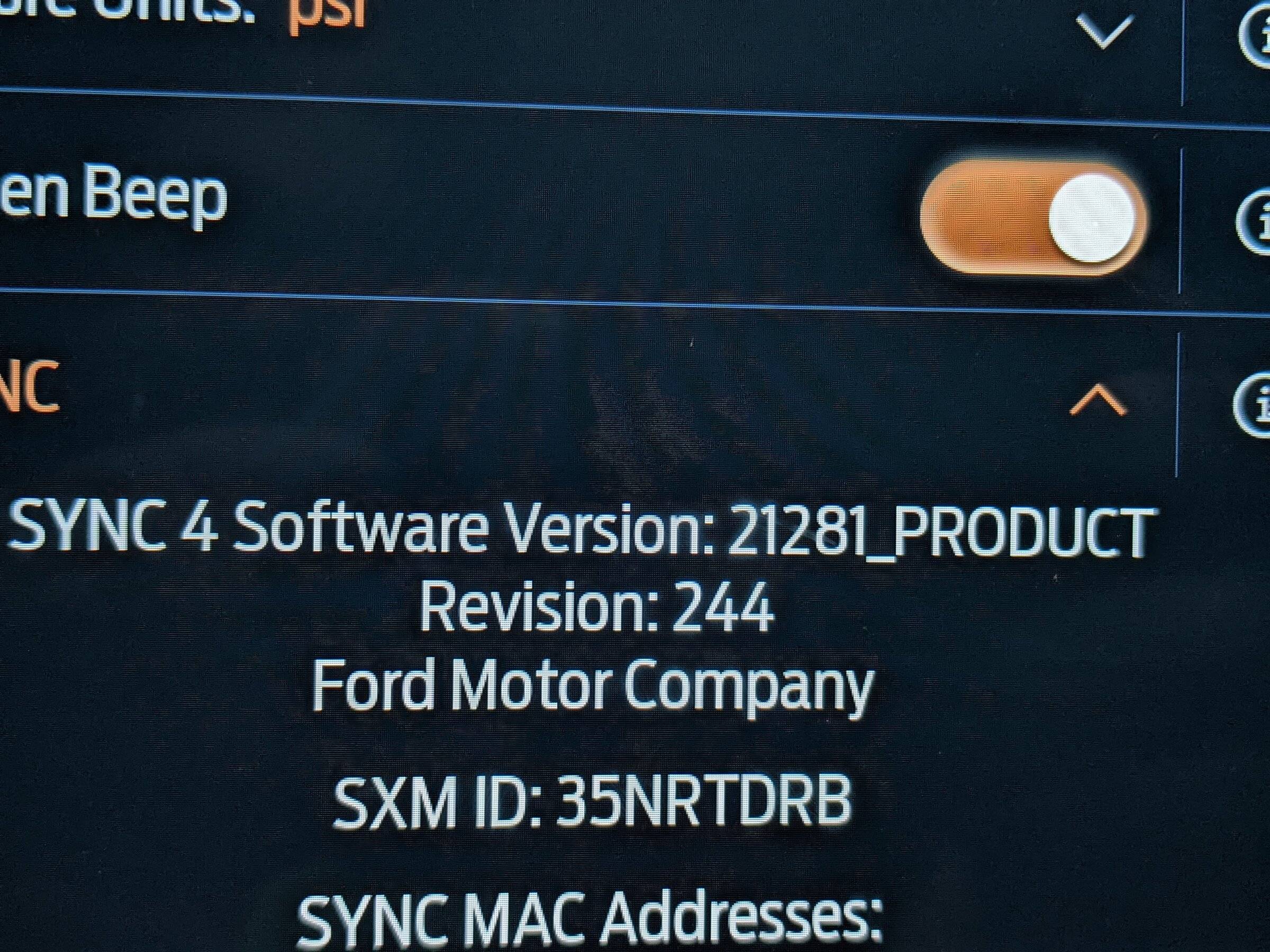

Check your Sync version. If it’s not 364 then I’d call the service manager in the morning and ask pointed questions.
Tom Jones should probably go back to singing if that's the quality of write up he typically provides. Seems pretty clear that the updates were not completed properly, and he certainly didn't test drive the vehicle in a handsfree BlueZone.

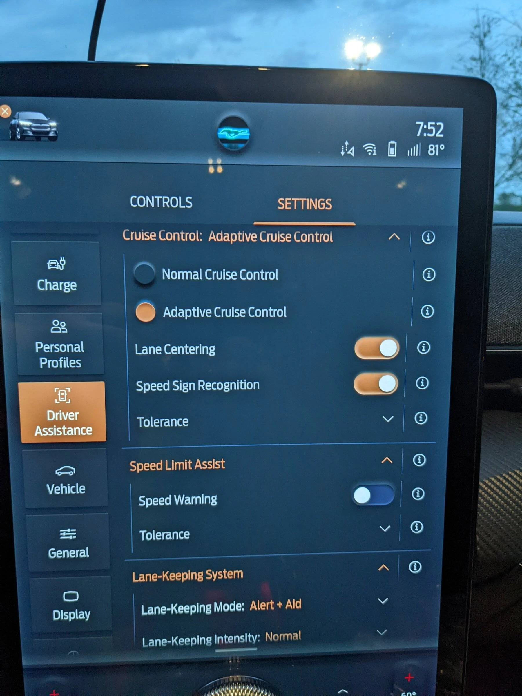

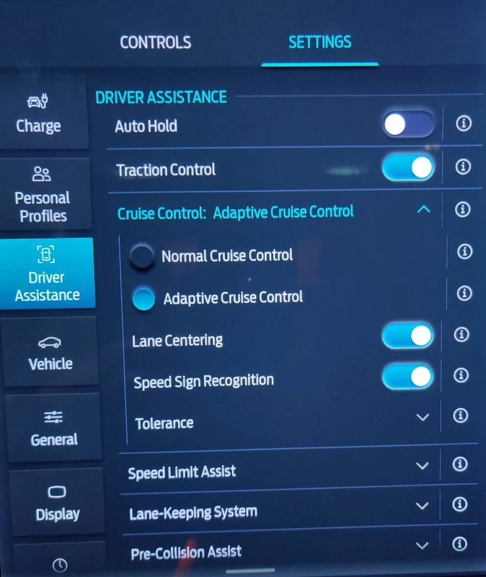

Besides the sync version, make sure Lane Centering with Blue Cruise is enabled in the Cruise Control Settings.

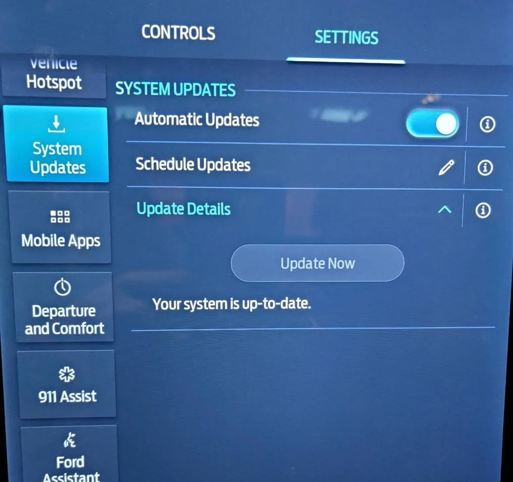

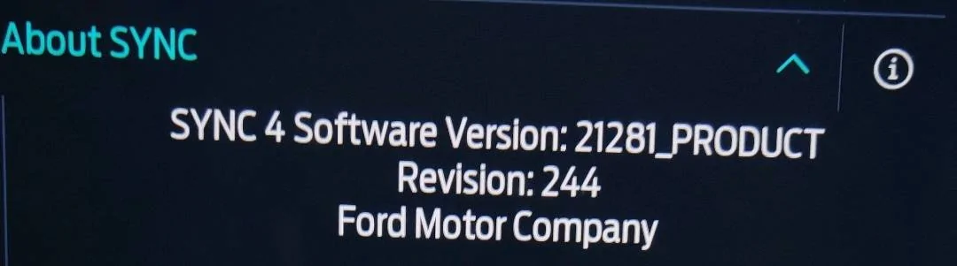

I've got a Job 1 Premium MME and brought it into the dealer yesterday morning for 21G01. They had to keep it overnight, and this afternoon, no BC, and it refused to engage lane centering on the way home.
Interestingly, the Blue Cruise section in my Ford connected services page, which used to say "coming soon!" is now completely missing.
(FWIW my update scheduling page now supports multiple days, so that's different...)

Yup looks like it's not been completed.
When updates are done using FDRS the power up version will not change. This is why yours still shows 2.1.0 it only updates via OTAs. But the sync version should have definitely updated if all the BC updates had actually been done.

Out of desperation I just did a factory reset to try to force-reboot SYNC as per those last instructions for 21G01.
Yes, that meant restoring the profiles, reprogramming my PAAKs, my PAAPs, my charge schedule, and everything else. It took a lot longer than I expected to recover from the factory reset.
Spoiler alert: a factory reset doesn't reset SYNC: everything's still the same as it was before. I guess I return to the service department tomorrow.
