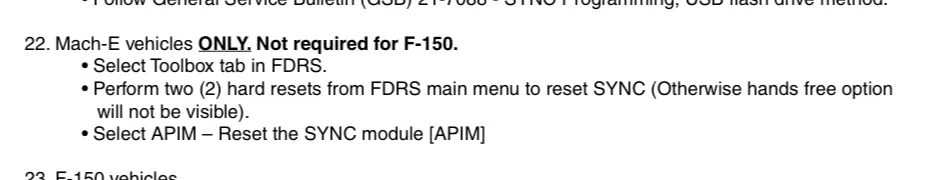

I had my dealer perform the 21G01 install Monday. That night I took it on two Chicago area interstates. Nothing. Today I took it on 4 other interstates outside the city. Nothing. Do I need to take it back in? I've got a 900 mile trip on Saturday that I was REALLY hoping to use it on ?
Call them and ask them if they did every step in the instructions. The last step is to take the car out on the highway and confirm it works, sounds like they skipped that and maybe some other steps.

Great news from the dealer this morning:
"It accepted the final update this morning and my Forman just got back from the test drive. He said everything is up and working now. You can schedule updates, auto update works and blue cruise is active."
