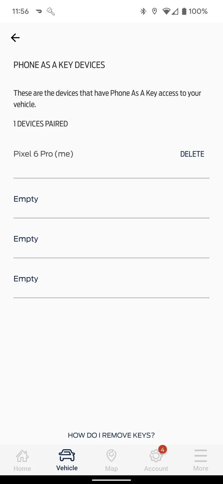

I've connected PaaK about 20 times already testing different things so it connects, it's just a PITA at times. Did you do the reset of PaaK in the car? I would assume at this point you probably have multiple PaaK profiles that are abandoned in the FP app.
In the app go to Vehicle - Features & Settings - PaaK Key Settings. Do you have a bunch of devices there?
