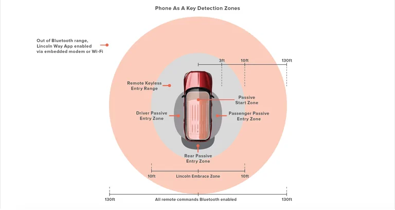

I'm guessing you encountered a software/firmware issue. The phone as a key is bluetooth to bluetooth. It doesn't require other networks. Here's a handy graphic from Lincoln. Bet something similar exists (or will soon) for the Mach-E...I haven't found it though :/

I mean...short of parking the car inside a farady cage...I suppose I could drive around for a while with everything turned off...but once those connections are off it's not like they have some network left in them like a garden hose. :p
" Compatible with Android devices and iOS versions 9.0 and higher, the system operates with Bluetooth technology to provide a connection in situations when there is no Wi-Fi or cell network available, such as in underground garages. Eleven antennas help achieve and maintain a solid connection, while the Bluetooth connection covers a circumference of about 130 feet around the vehicle. "
https://www.caranddriver.com/news/a28751902/lincoln-phone-as-a-key/
Faraday cage or drive out into many of our National Parks.
I concur that the connection between the phone and car is Bluetooth. However, what is being passed? As I posted above, I wonder if there are private/public key or token systems being passed to the phone app and car that are updated on a certain time interval. The token(s) may be passed via bluetooth and confirmed. If the phone &/or car have been out of cell signal during the entire time since the expiration of the last token, that may prevent PaaK functioning.
