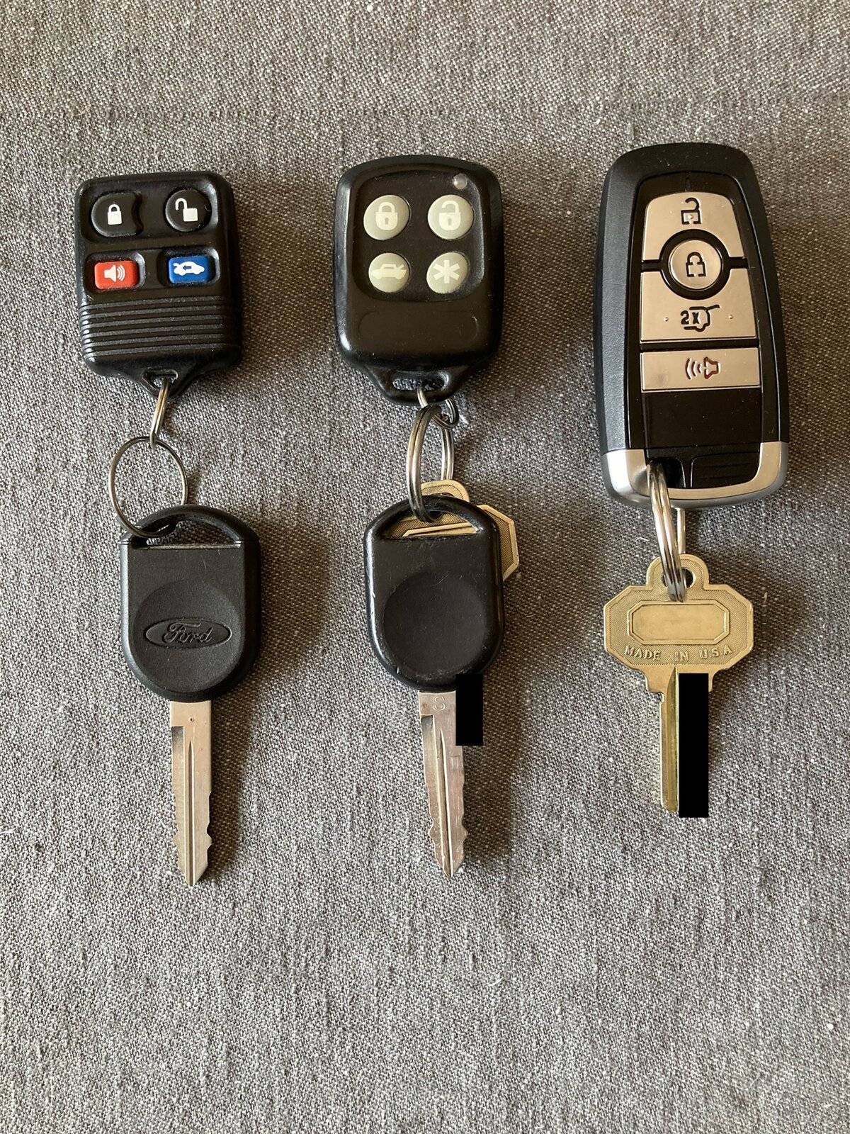

Side by side comparison: MME and FFE fobs:
Since we are whipping out our key fobs, here is a pic of my 2006 Mustang’s original key fob on the left, an aftermarket key fob I’ve used for it since the day I got it in the center, and the Mach-E’s on the right.
Ford Mustang Mach-E PaaK seems to require cellular service C05956D7-B7DF-4499-B2ED-D9EB6B0579D5
Seemingly all key fobs across all brands have gotten a lot bigger over the last 10 or so years, not sure why. That’s one reason why I like PaaK, the Mach-E’s key fob is like other modern key fobs - too bulky.
